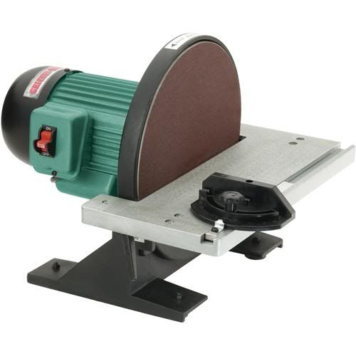

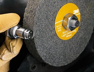

The 12" disc sander with 80 grit is what I use at the shop. I also put the bolt in a Makita drill and hold it flat against the base of the sander's table. Then I make a pass with the deburring wheel, a few passes on the surfacing stone with 180 grit wet , and straight to polish. Takes about 30 seconds or less per bolt to get the letters of this way. It's faster than setting them up on the lathe. If you can find someone with one of these sanders to borrow, it will make quick work out of the bolts.
