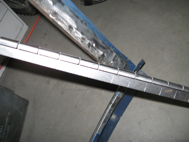

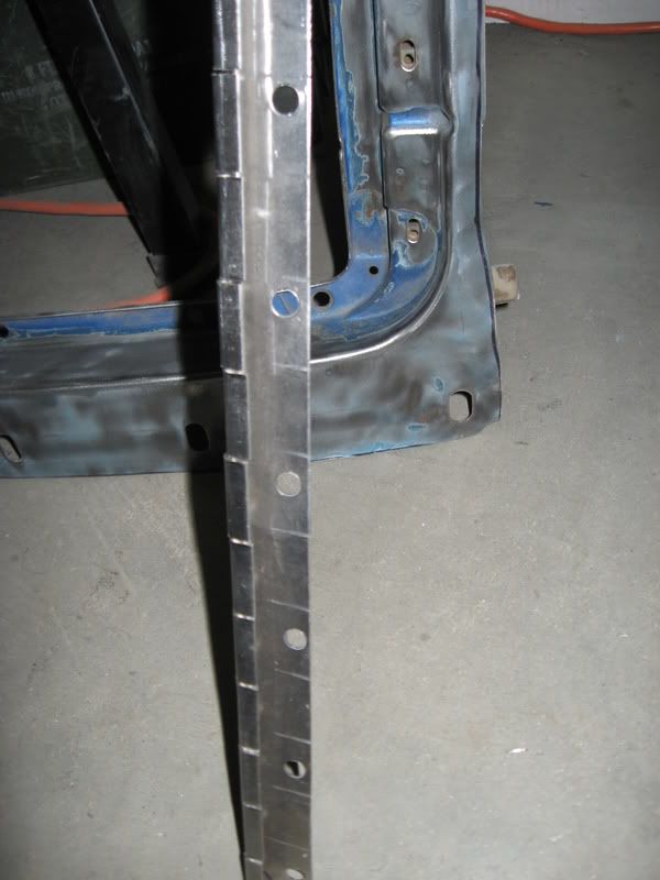

Ok, this is small stuff, but it needed to be done. Here are the rails that Eric sent me that now have the little slots cut in:

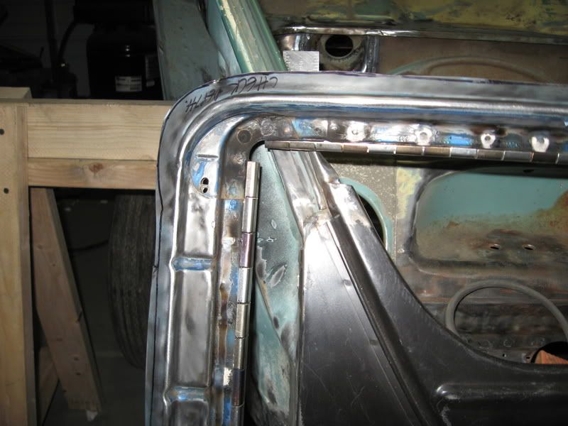

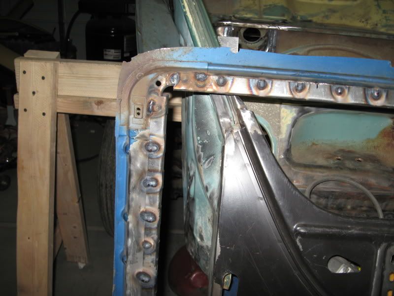

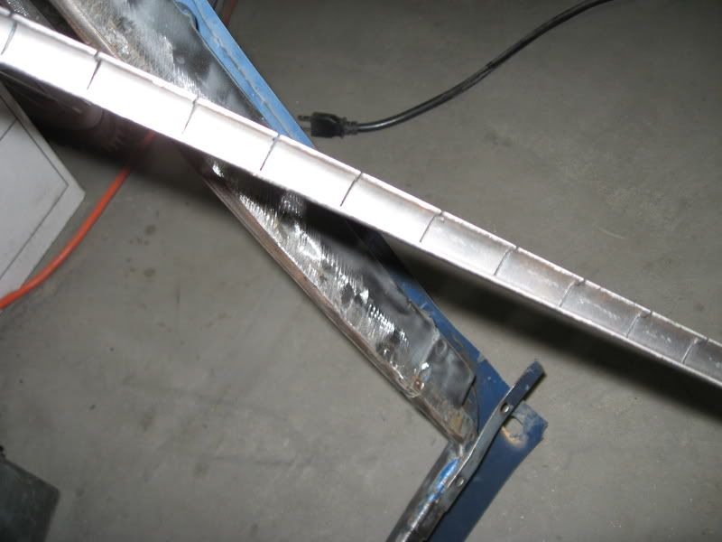

Here the holes are punched to plug weld them in:
And here they are welded in:

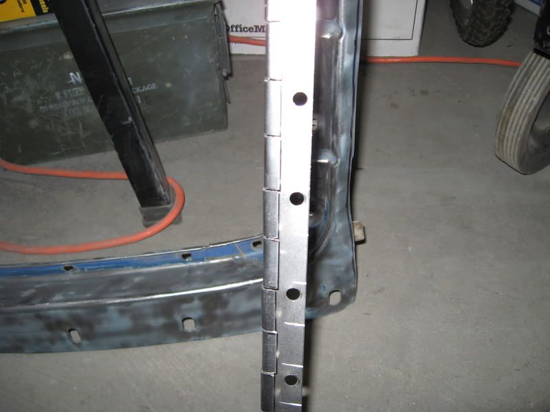

This is now looking stock on top:
Just have to grind the plug welds smooth, along with a few other welds and then I should be ready for some measuering of the roof for the big cut.

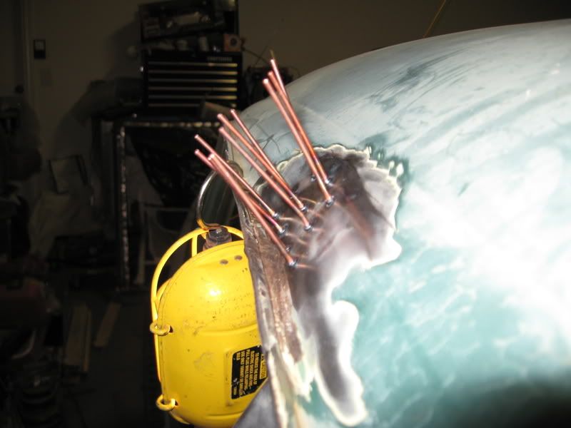

Thanks guys. Finished grinding the welds for the ragtop today. I was planning on cutting in the ragtop next. The problem is that I have two dents on each side of the roof from where the previous owner used blocks under the tie downs. I think that I will pound those out first so I dont create potential problems when I fit the ragtop graft. Pics to come soon. I am still trying to fill in this pesky hole on my firewall that I keep chaseing :x

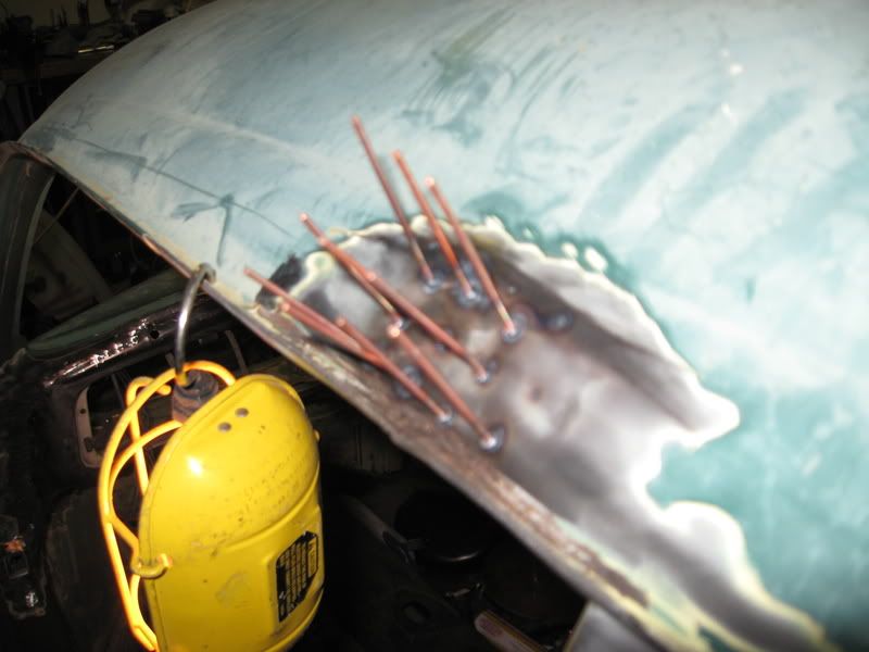

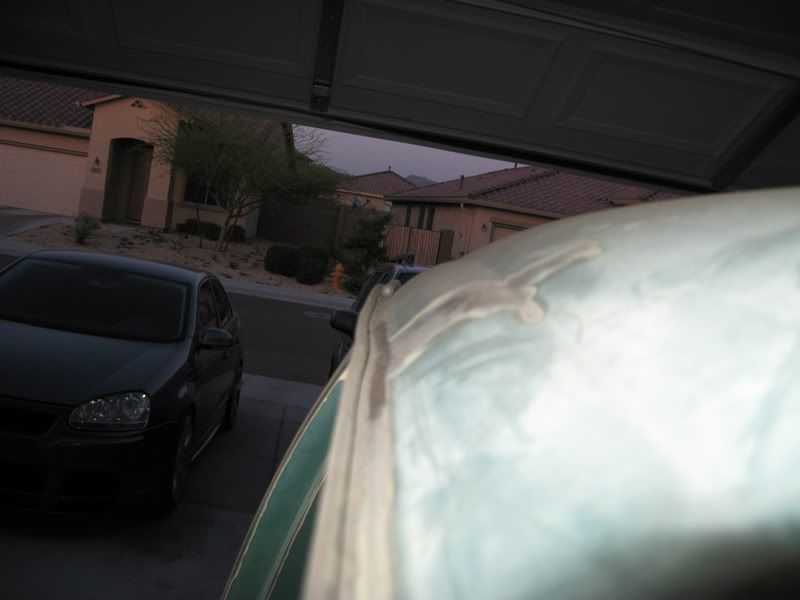

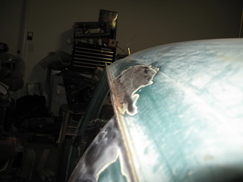

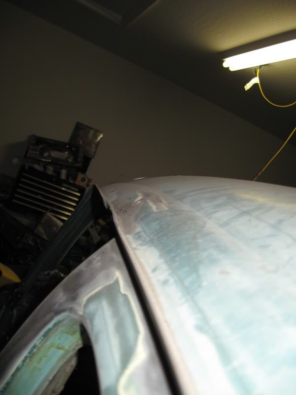

The PO really fubared the right side when they tied down the body. It really doesnt show it well, but the dent goes into the door frame. So I did the best I could to pound them out and line things up. Looks good to me, but no perfect by anymeans.
Before:
During:
After:
There is a kink in the metal on the drip channel that I will have to file out when I start doing the body work.
