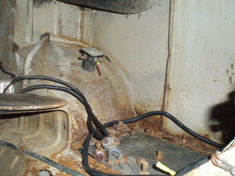

had to rip out that damn starter solenoid that started the whole electrical nightmare...

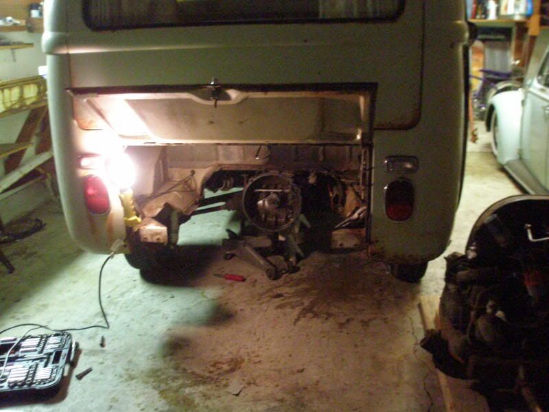

The engine will slide out like that, you'll have to pull one side (right or left) first then the other, but it will come out. You don't have to put the engine on the ground and roll the bus forward (although that will work). I was able to finagle mine out of there with the dual carbs on.

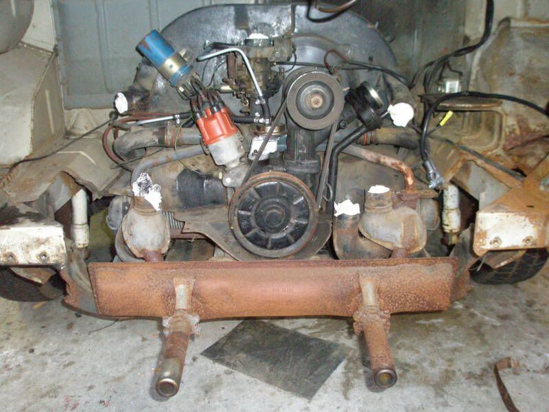

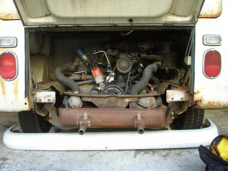

my buddy Omar (outoftheoffice) came by tonite for a couple hours and we got a large step closer to the tank cleaning. this puts a major dent in the list of things to do before driver status/ monument show... pics of the mayhem
omar taking a nap
out she comes...

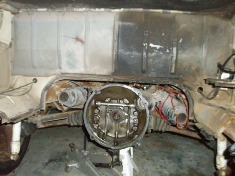

a good cleaning tomorrow for this one...
looks fine from here...

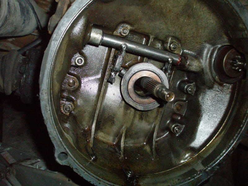

but upon a closer examination (notice broken spings resting on the bottom of trans, and the worn/welded on fork)
