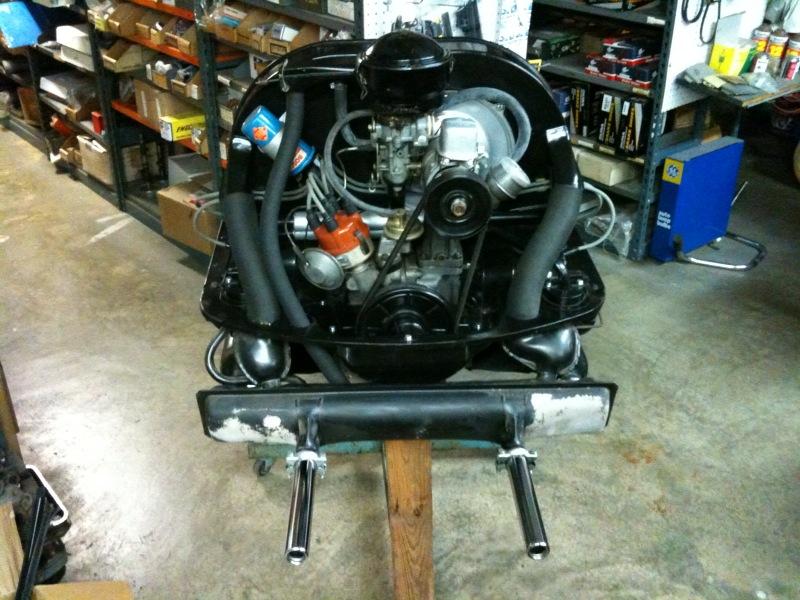

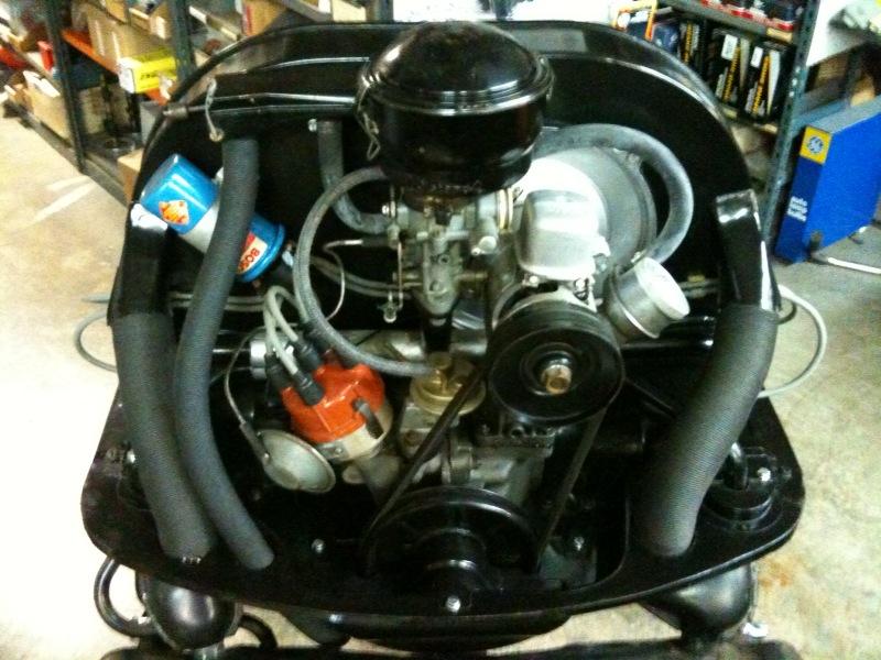

Well an update is long past due. I have been working on a little project at work. I think that after installing this the car will be much more enjoyable. I am converting the car back to a 40 horse and 6 volt electrical.
