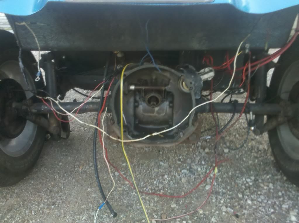

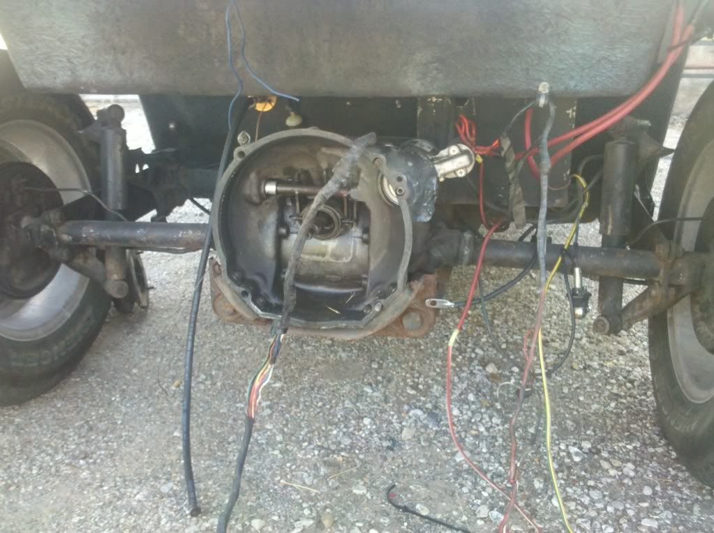

Been working in the wiring this evening. Its a mess, but I think I have it all sorted out.

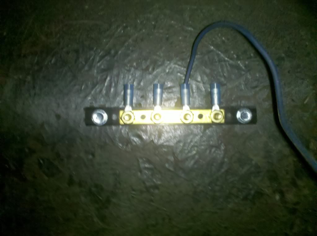

Been doing a little bit of work to the wiring.
Grounding block installed for the rear lights. The way the lights were grounded before was to the fan shroud, which wasn't always grounded.
Gonna install some more of these in the future for the front grounds and for the dash grounds. Handy and pretty inexpensive.

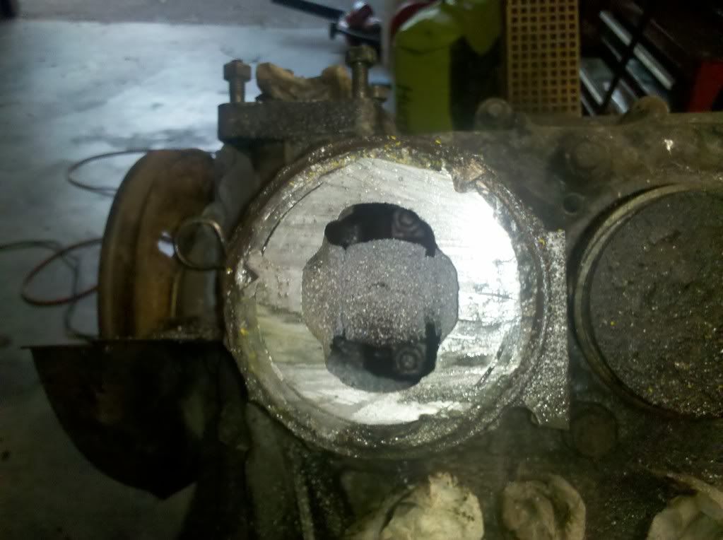

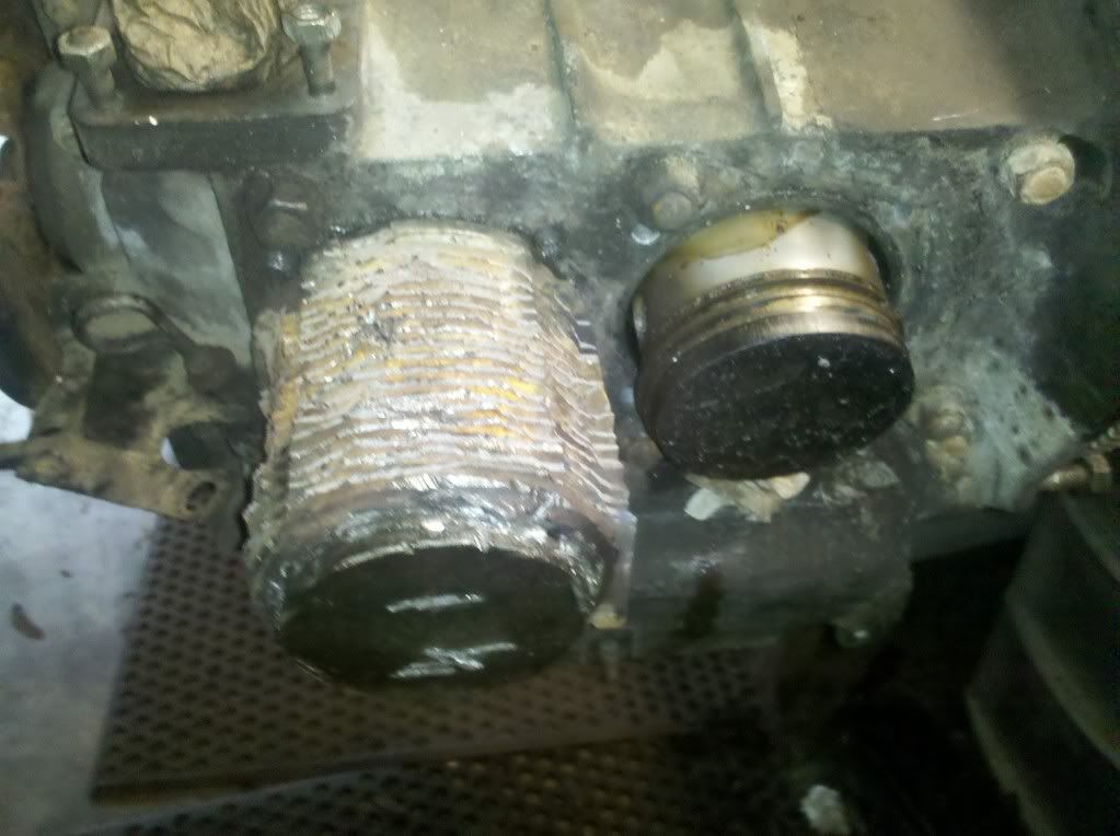

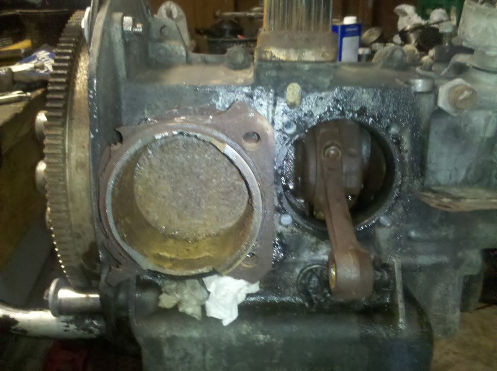

Some more engine pics from tonights festivities!
Swamp monster piston drained
Frozen #1
Cut #1, ready for removal
So much metal shavings, we decided to split the case. Which turned into a massive project. #2 piston also had to be cut up so we could reach the rod bolts. All the lifters were frozen in place. But the crank bearings are original, could read the VW part # and also the VW emblem, so progress is being made!
