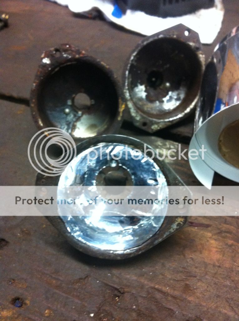

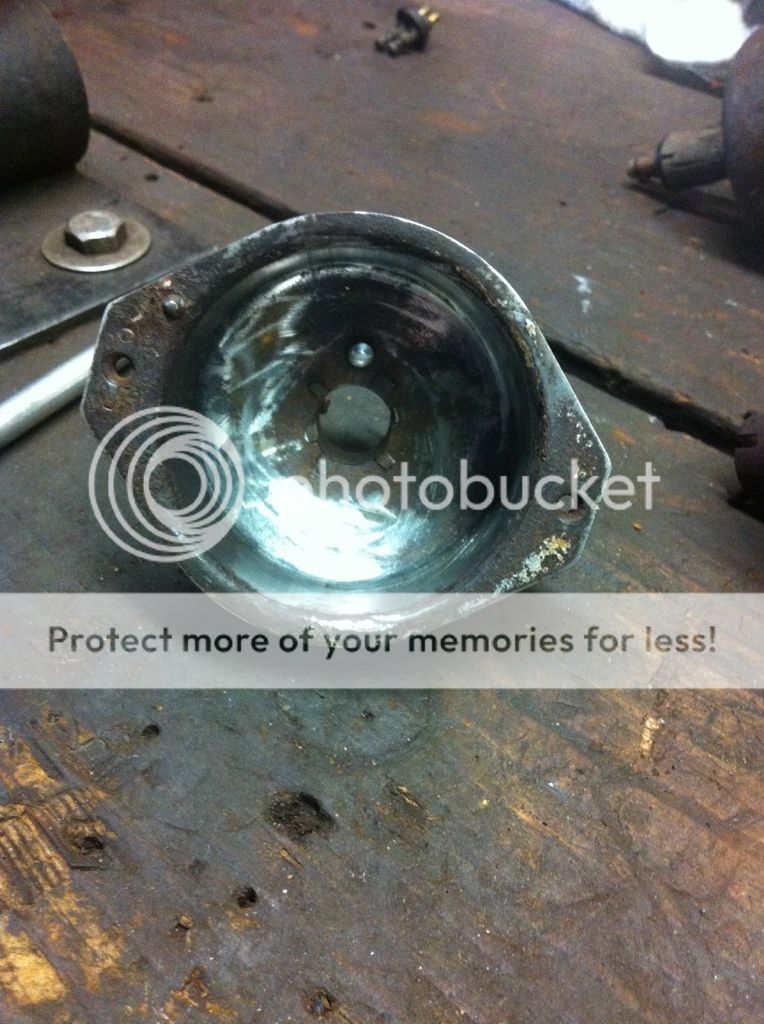

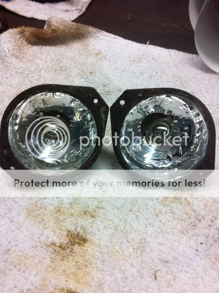

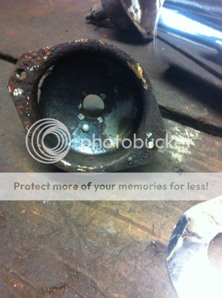

Head lights are now H4. Running lights are now 12V. Installed headlight and turn signal gaskets. I then rebuilt the tail light assemblys. It took 3 of them to make 2 nice ones. I lined the inside of them with chrome tape to help with reflection. Cheap fix.

Good idea with the chrome tape!
PostPosted: Fri Jan 11, 2013 8:33 pm
I was so embarrassed to ask for it at the parts store. It was like buying rubbers when I was 13.....
PostPosted: Sat Jan 12, 2013 9:13 pm
PostPosted: Sat Jan 12, 2013 9:25 pm
x2

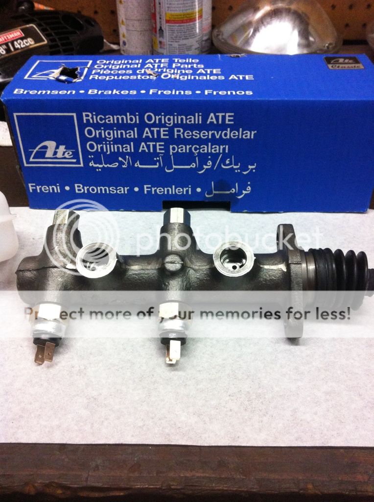

'67 only dual circuit master. Never thought I would find one. Came with switches and pressure pots for the drum brakes. I might have to reroute 1 brake line, but haven't looked yet. If I do, it will be super easy. Bus' have a T fitting for the front brakes and the rear brakes. T1 only has a T at the rear. And no need to modify anything else to make it work!!!
