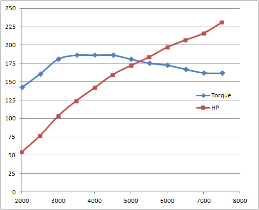

I did a bunch of unconventional things, compare to motors that supposedly make a lot of power but are undrivable turds. Short rod ratio, short manifolds, relatively low duration (310), "only" 48 IDA's, "only" 1 3/4 inch exhaust, etc.
Made 231 at 7500 and probably would have continued pulling to 8k easily based on how the torque curve looked at 7.5k, and it made 75% of peak torque at only 2k rpms. And those numbers are on pump gas, with the belt and muffler on a very conservative dyno. I putt around all day in 4th at 1800-2000 rpms in stop and go traffic and it runs cool. That's my combo ;)

The heads are DRD L7's, but with custom 7mm stem Ferrera valves, PAC LS1 springs, and titanium retainers. I got the weight of the valve train low enough that I was able to run only 175 lb seat pressure, and 415 lb open pressure. With Pauter 1.5's I've got .655" lift at the valve. Valves are 44x37.5.

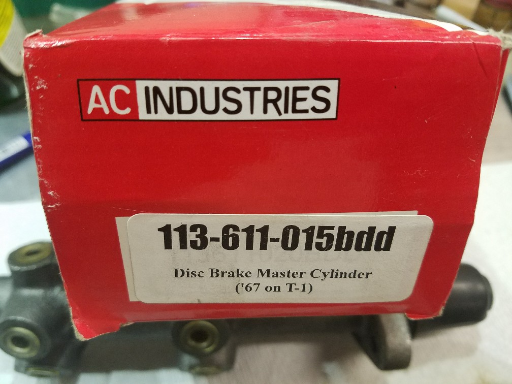

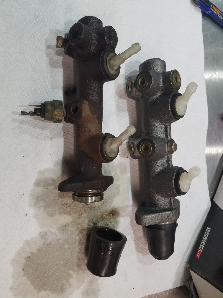

So yeah, the master cylinder was the culprit. I saw some signs of leaking around where it bolts to the body, and then when i pulled it out and removed the rubber boot a bunch of fluid came spilling out.
Here's the replacement, I've had this for years, brand new in the box. Its more appropriate then the one i had since its made for 4 wheel disk brakes.

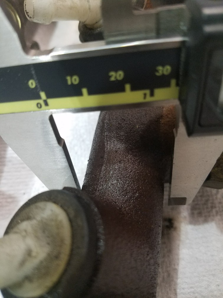

The caliper is showing the diameter of the new one compare to the old one, its like 2.7 mm bigger. I'm sure the pistons are similarly upsized.
Should give me a bit more braking power.
