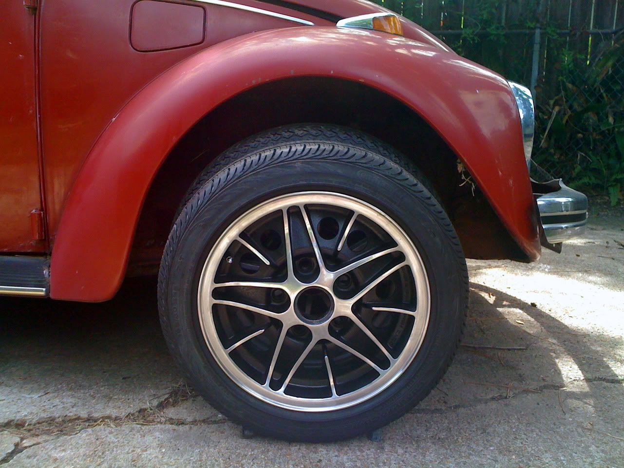

I know a lot of people ask the comparison for the smart car tires to 135's/145's alot
135's behind my 155/60/15's
not much difference.........

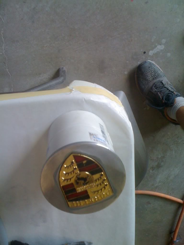

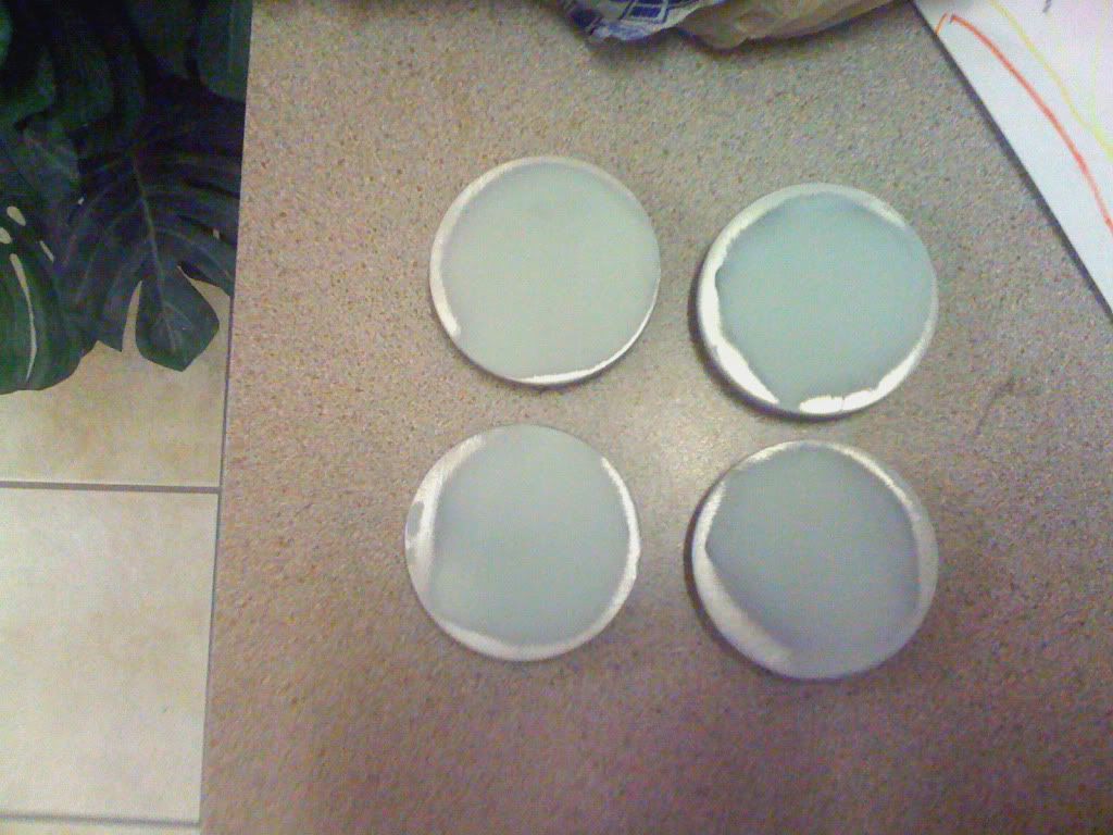

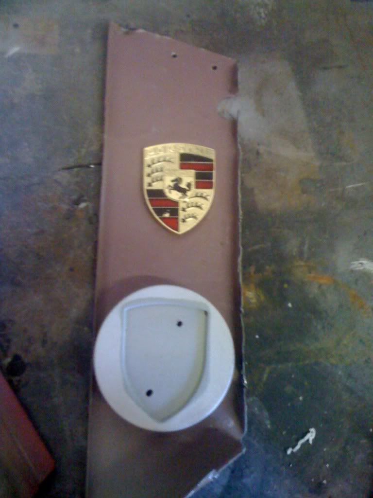

I started with the Porsche center caps I got from FVD http://shop.fvd.de/de/en/Porsche-0/-/-/-/item/item...Crest.html
Then I made a jig out of 2" PVC,drilled hole and riveted the center cap to the PVC..

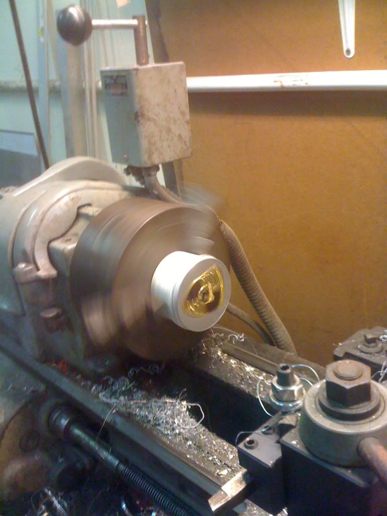

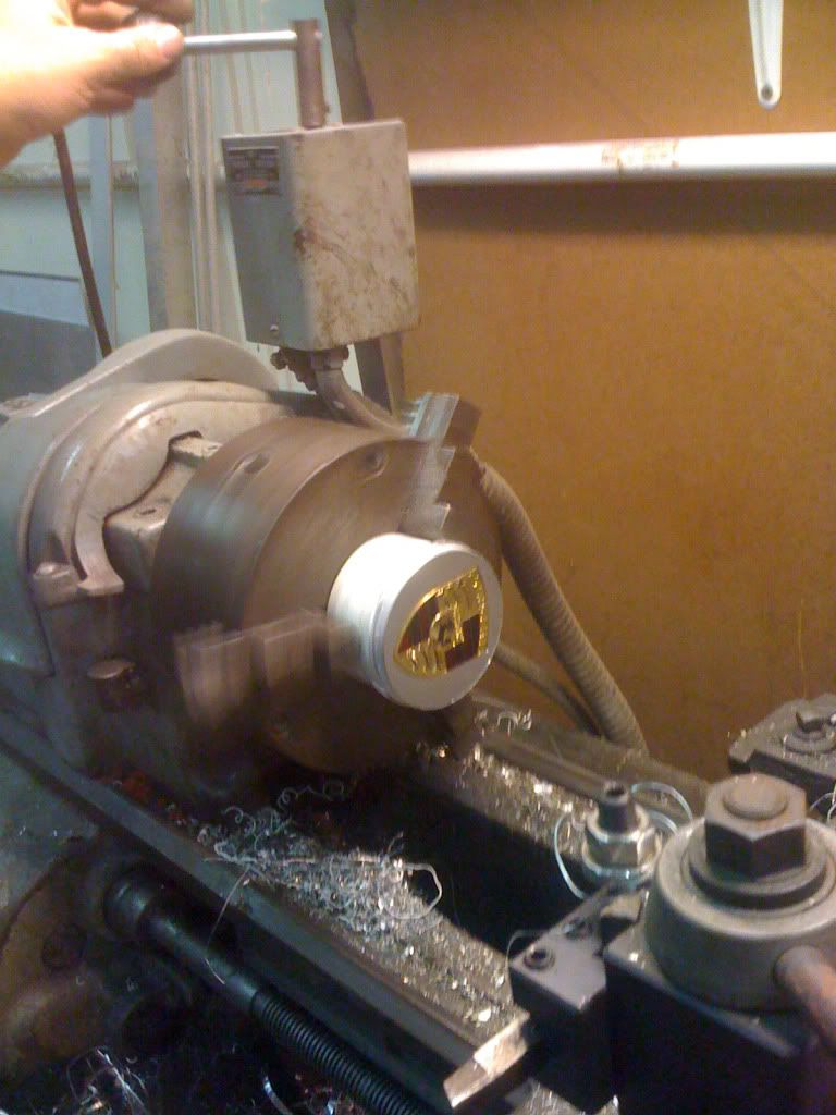

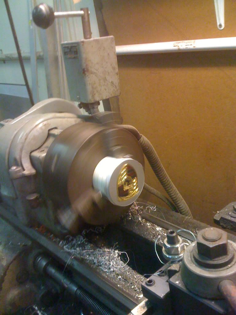

Then off to the lathe to take about an 1/8th of an inch off....
The first test fit...

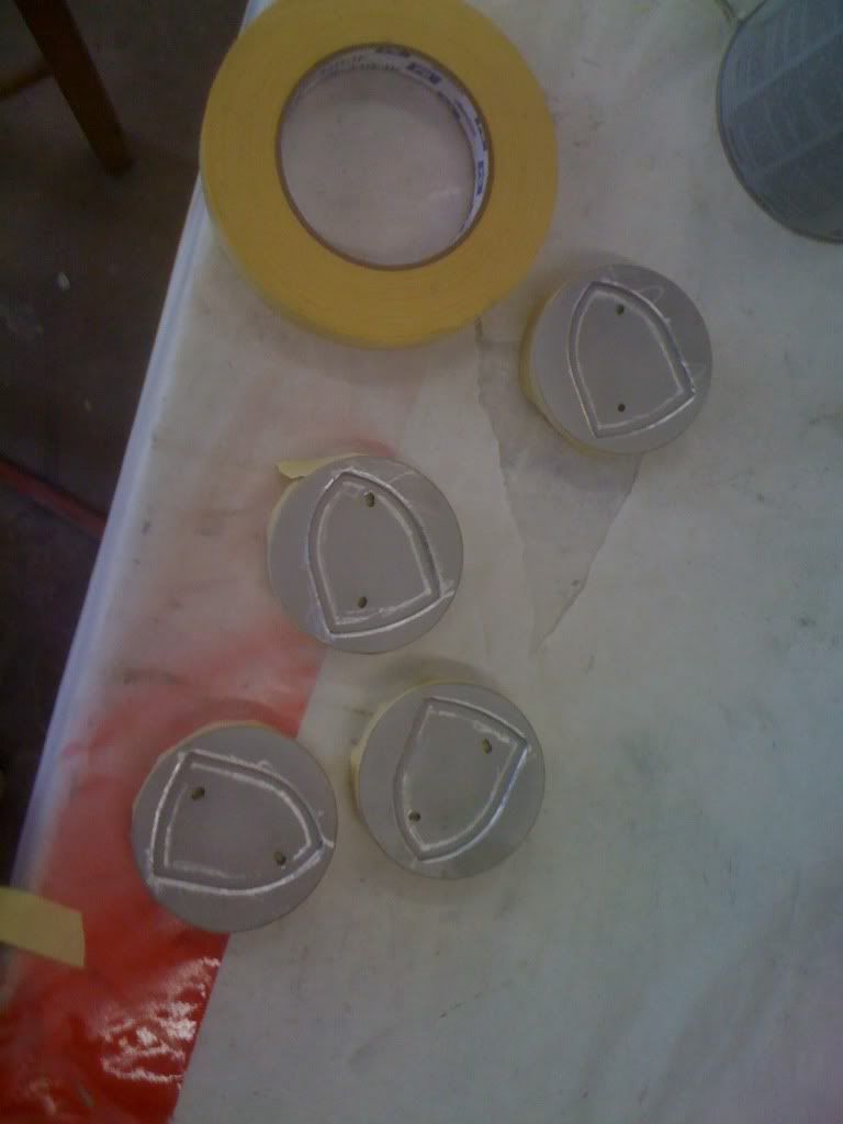

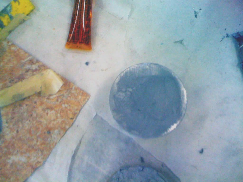

Then debadging the cap and sandblasting..
Then filing the edges of the crest...

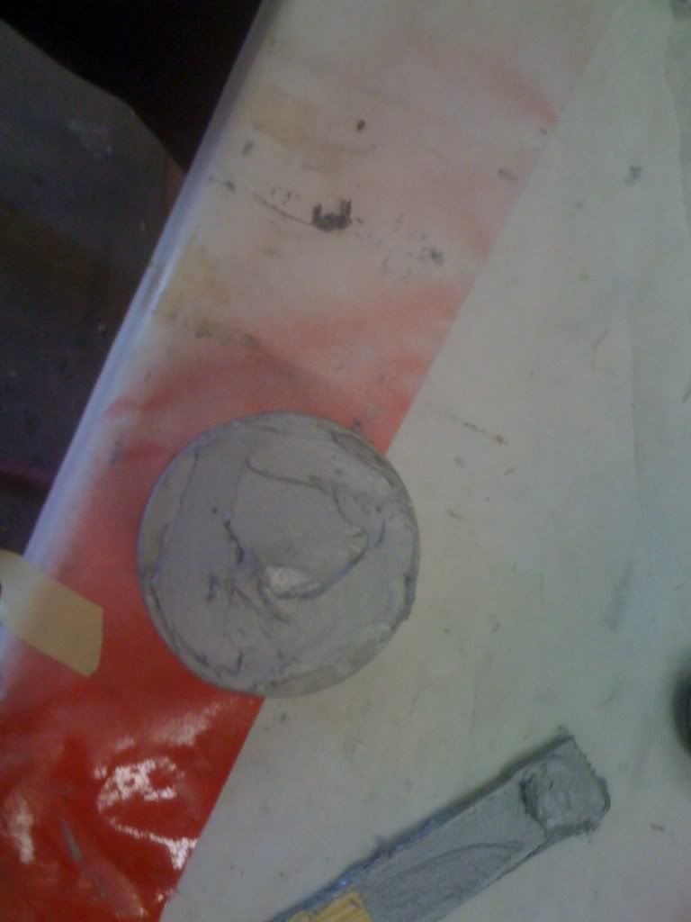

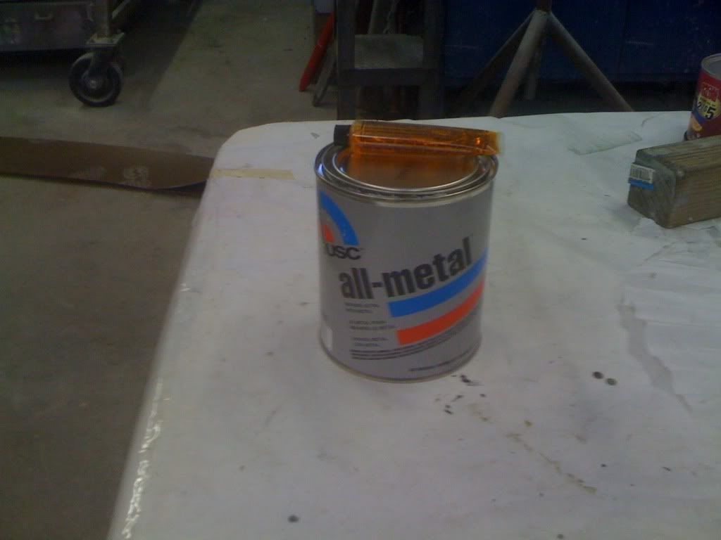

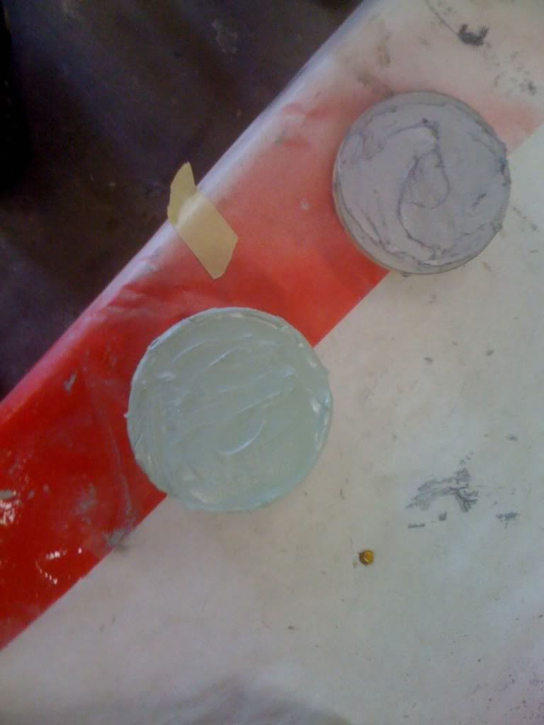

Then using metal filler,fill up the crest cavity..
Then sand them down and use regular body filler..
More progress soon....

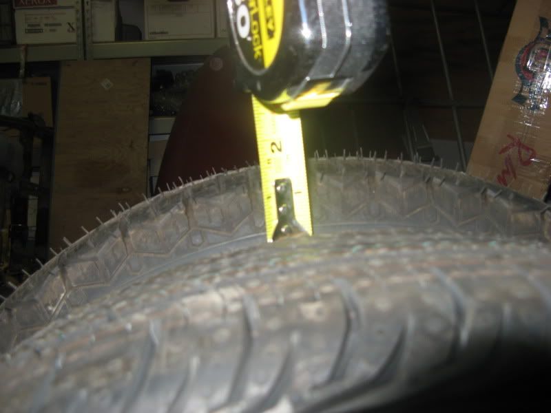

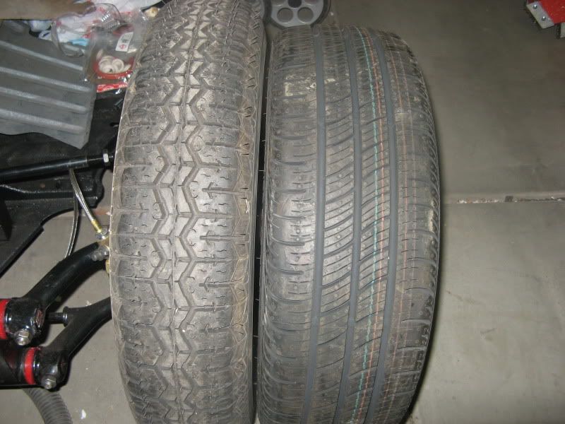

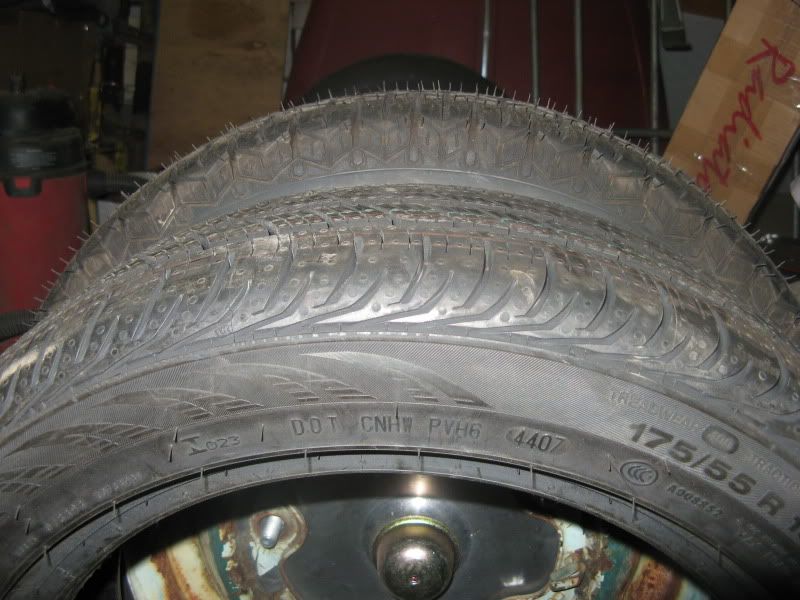

There is quite a bit of difference with the 145 and the 175/55/15 imo. Here you can just make it out the 175 is just about 1 3/4" smaller and also here is a side by side comparison. As you can see a lot more contact patch for better stopping. Thats why Im going with these on the front of my car. Plus they will fit the 5.5" rims nicely :thumbs:
