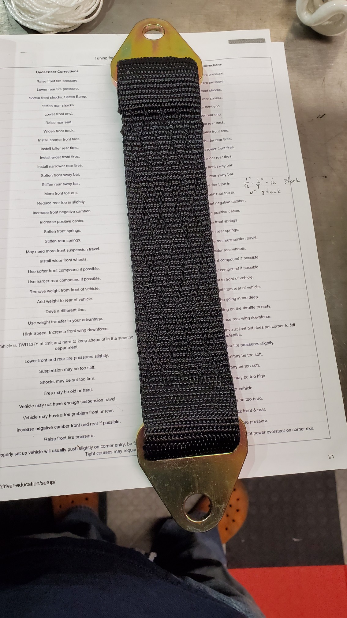

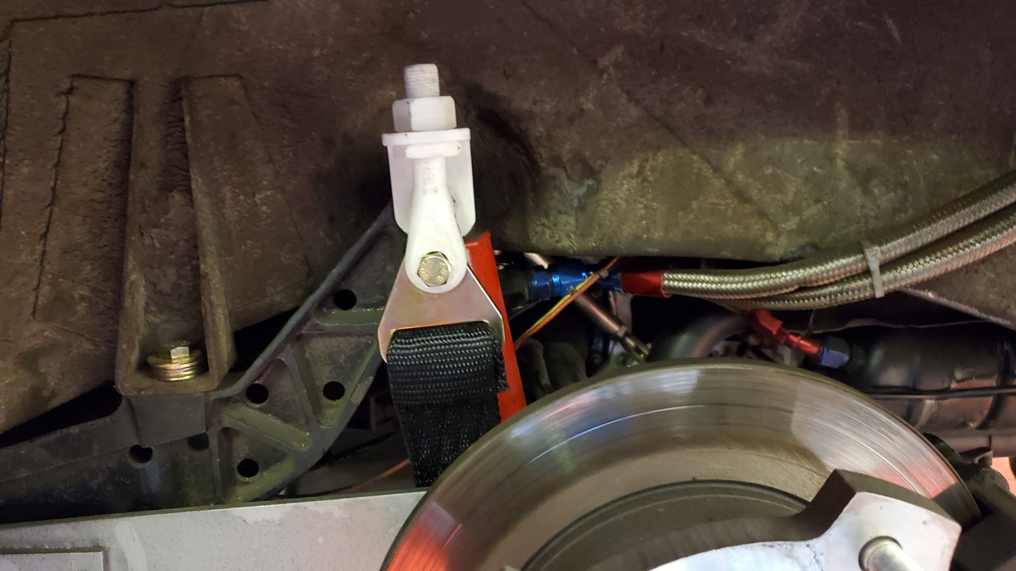

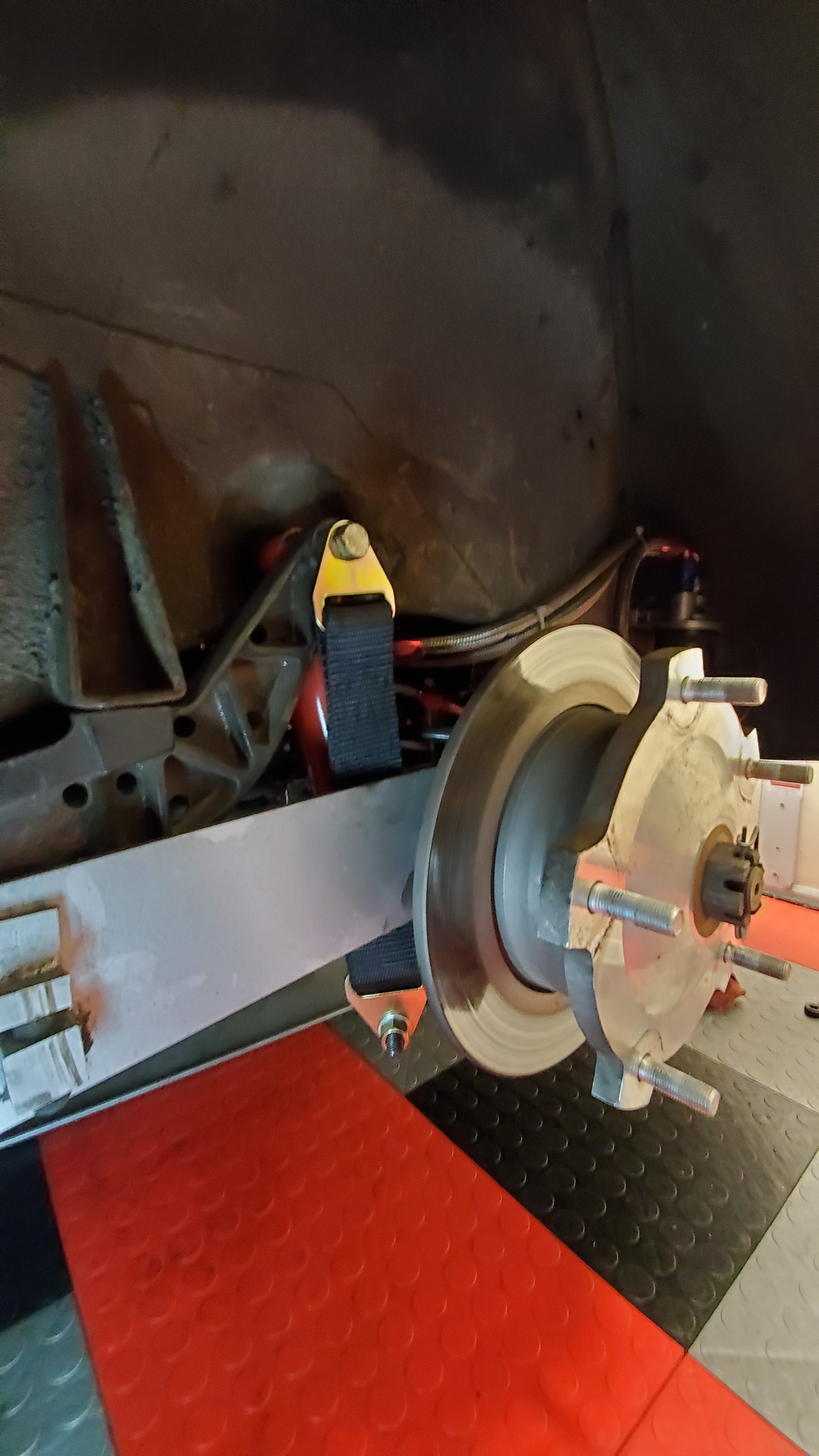

First thing with swing axle cars is controlling the rear suspension, and making sure that the outer tire doesn't jack during a turn. Jacking can lead to poor handling, or rolling the car! Negative camber helps for sure, and I'm at 3-deg negative in the rear right now. But the travel still needs to be limited. There's a couple ways to do it, and I decided to use limit straps. I took a bunch of measurements of the suspension movement and settled on 12" straps.

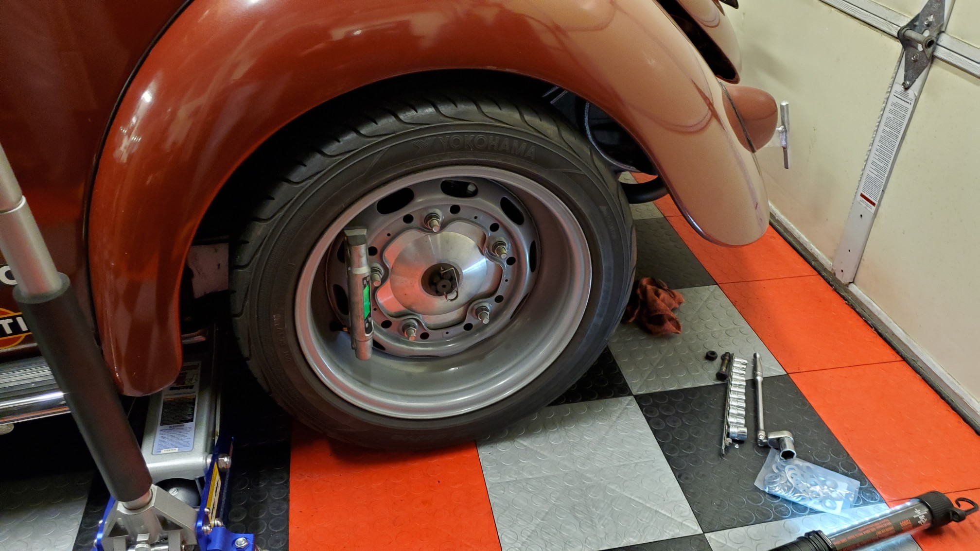

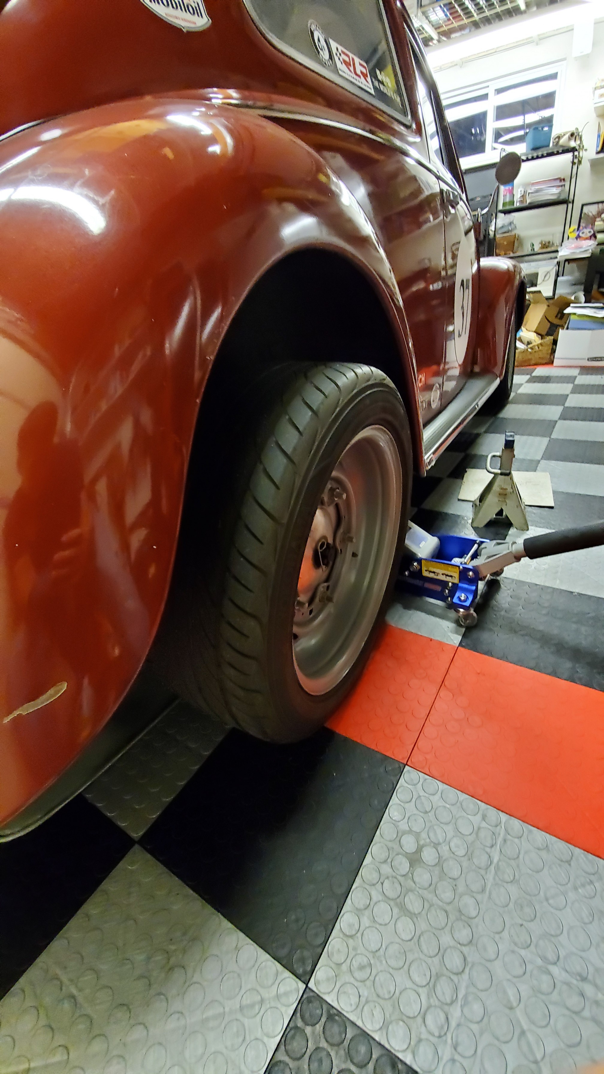

Here's the droop without the straps. You can see the camber goes several degrees positive when the spring plate rests on the built in stop. I would NOT want the outer wheel doing that during a fast turn!
Here's one of the straps installed
And the new travel limit with the strap. I've got it limited to about 0-1 degree of positive camber, which still gives pleanty of travel, but should keep things in check.

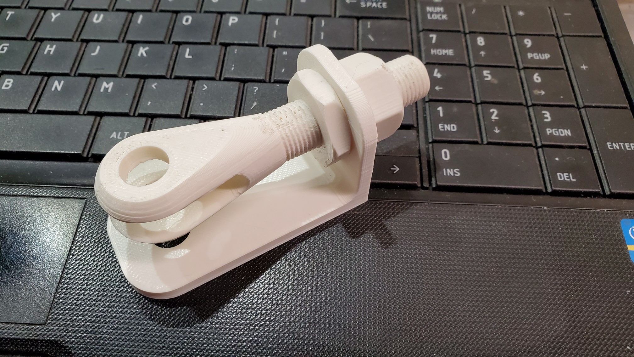

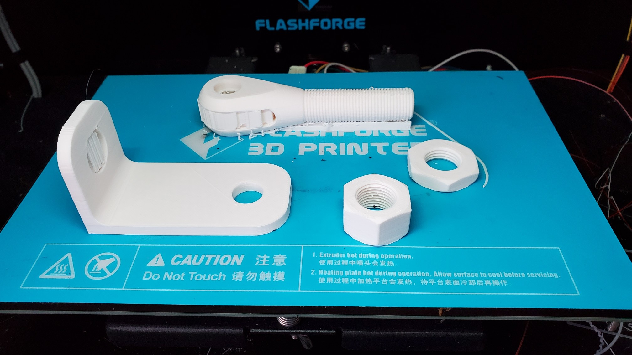

I like the idea of adjustability on things, so they can be fine tuned. I started playing with a design for adjustable limit strap mounts so I could dial in my suspension travel (more for the street, less for the track, for example). Enter my 3d printer. Rather than buy the hardware I needed, I just printed it so I could check the concept before spending a dime.
Assembled
And fit on the car for checking clearance. The upper mount location of the strap can be adjusted a total of 1" for fine tuning.

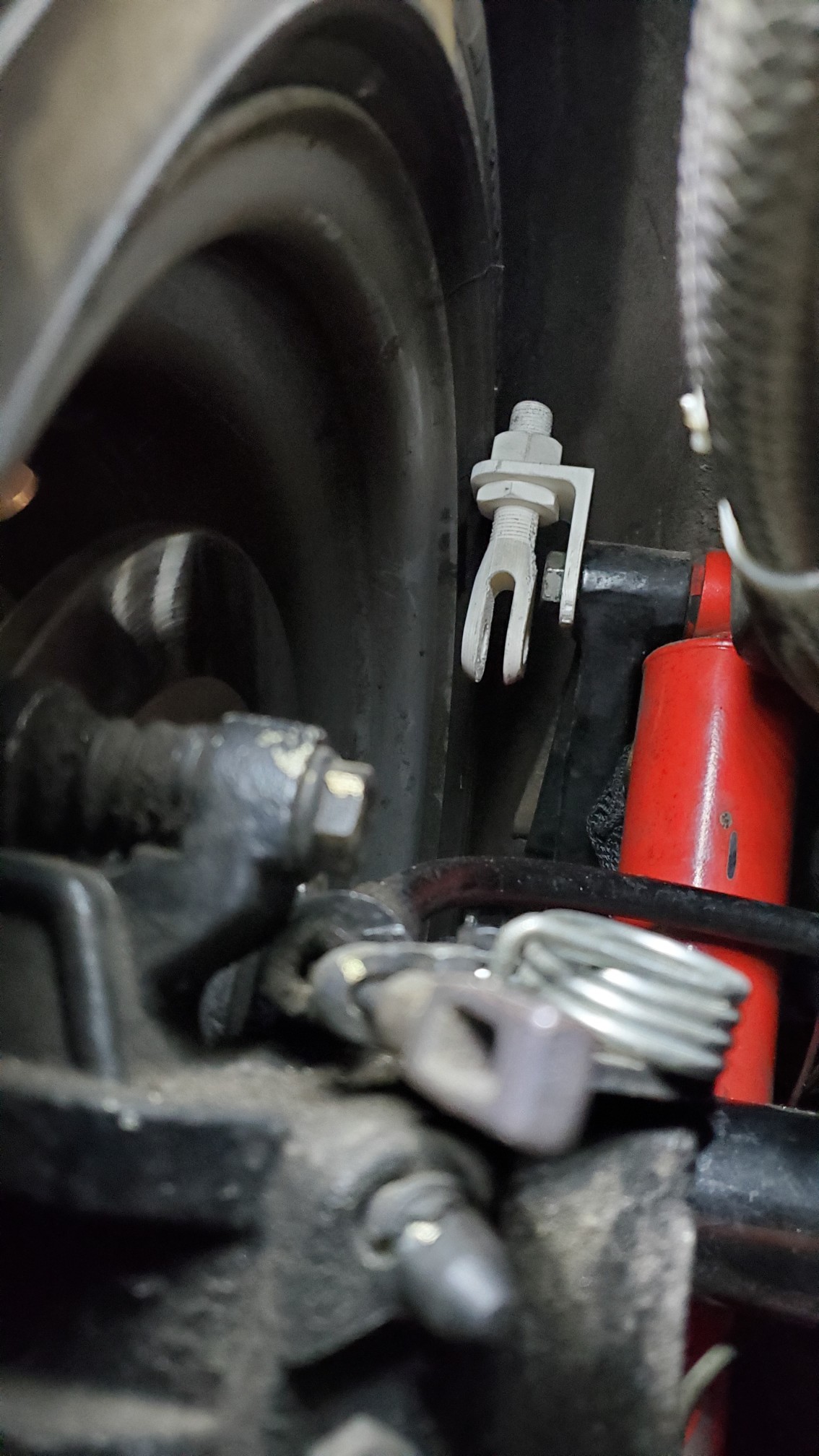

As I feared though, the mount would hit the tire as I saw when I reinstalled the wheel and cycled the suspension. At least I hadn't bought anything or wasted time making the L bracket from steel. The printer is so handy for this type of concept testing. I've got an alternative mount in mind that should clear everything no problem. I'll mount up a printed version of it soon to check. Here's the tire hitting the original concept.

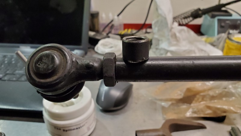

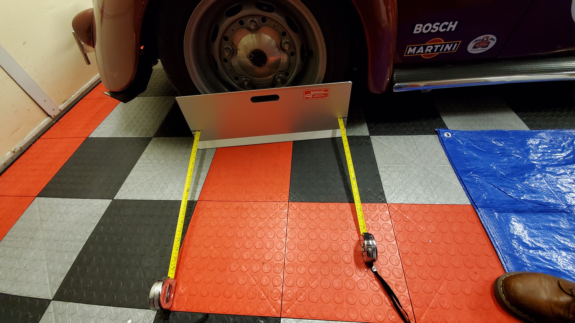

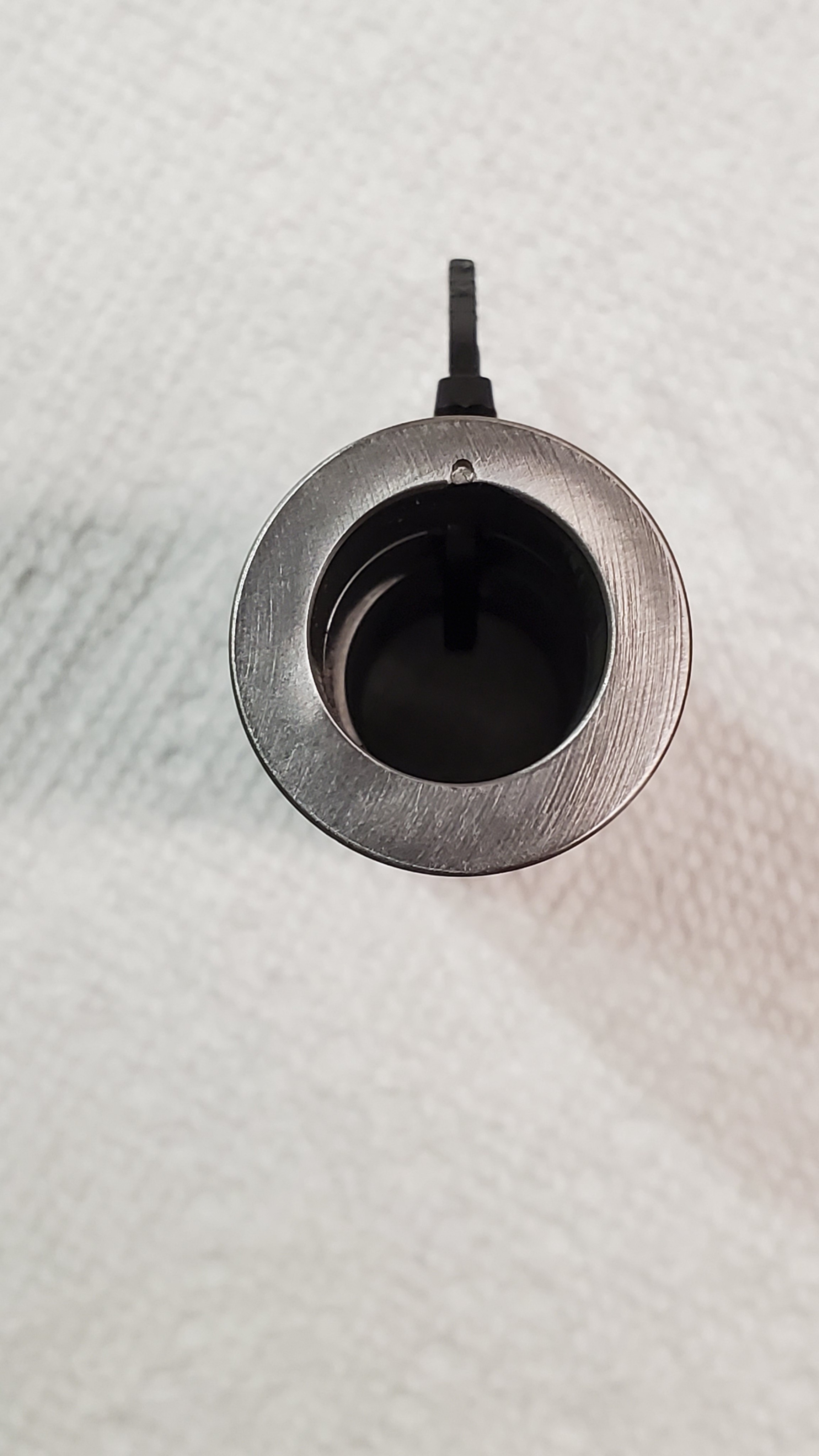

My toe plates came in so I've started doing an alignment on the car. Man was it off! I was at about 5/8" toe in on the front, the spec is 1/16" to 1/8". All that toe was just wearing the tires fast and scrubbing speed! The right tierod needed to be shortened, the ends were bottomed out and the overall length was too long. So I cut about 1/2" out of it and ran a tap through it go get more threads. The tap is a 14x1.5.

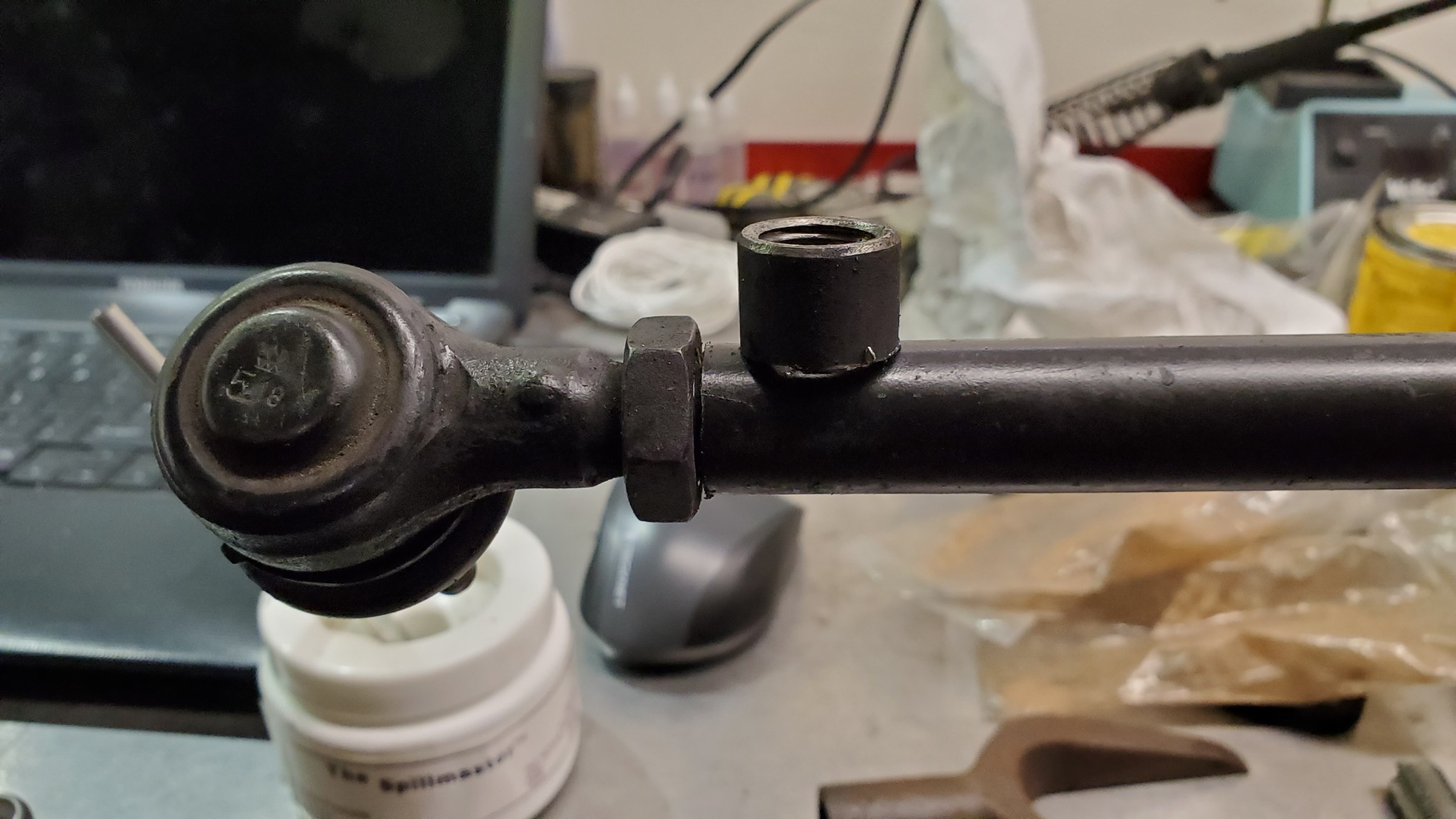

Tapped it far enough that I could bottom out the tierod end. That's the piece I cut off sitting on it.
With the tierod shortened I was able to set the front toe in to 1/16", just where I wanted it.

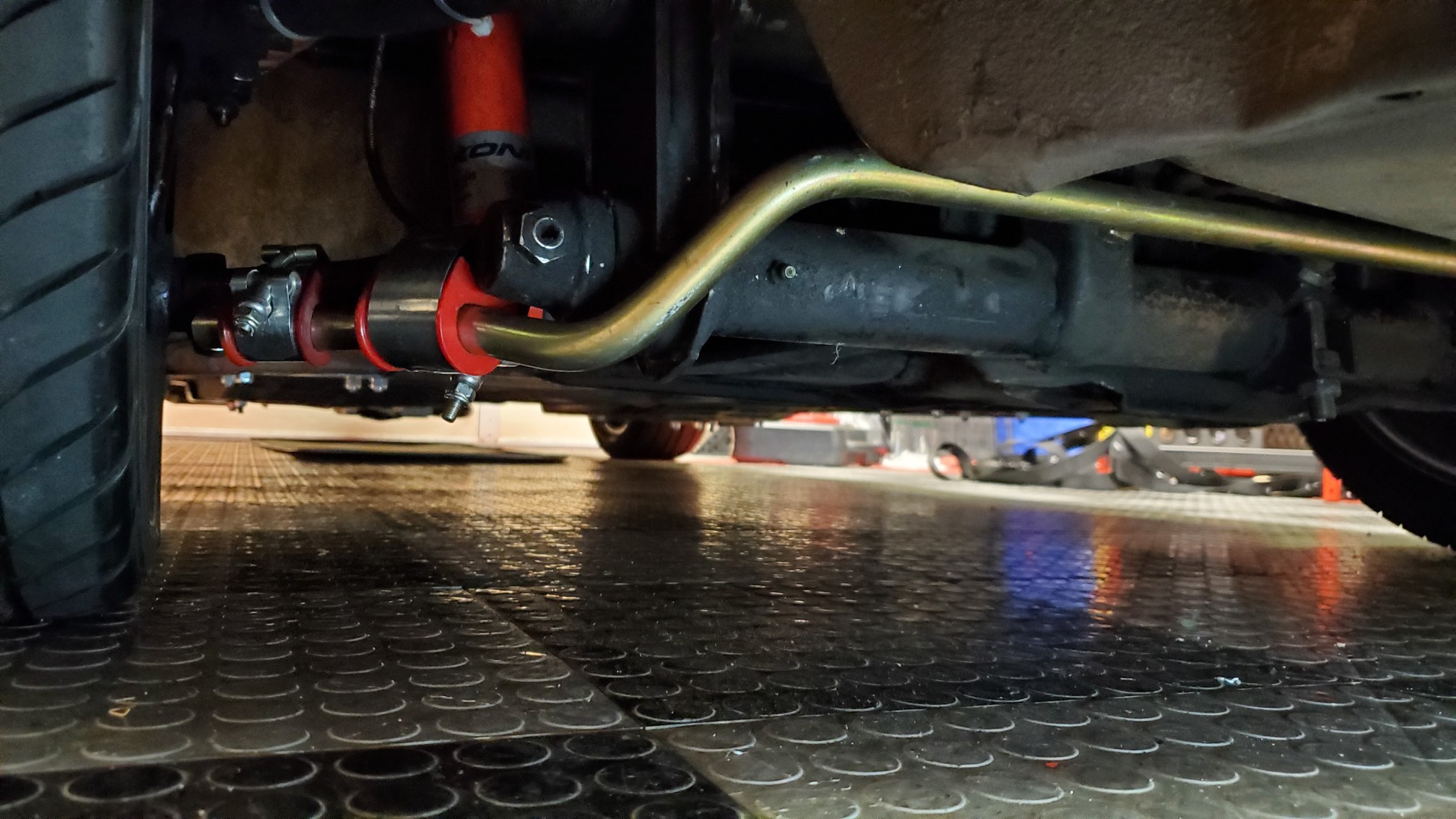

And finally, last night I finally put on the front sway bar I had bought many years ago for the car. It's made for a 2-3" narrowed beam, and mine is 4" narrow. I had to cut about 1/2" off each end to compensate for the narrower beam. It was a huge PITA to install, those t-bolt clamps really don't want to conform around everything. Many a 4-letter word later and I finally got it on. Swing axle cars have very high rear roll resistance, so the front bar should really balance the car by adding front roll resistance.

Hey Ethan. Toe plates are Longacre LON52-79501, about $65 on Amazon. I'm very happy with them. Amazing how much my alignment was off from just eyeballing it lol.

Yeah, one person no problem. One of the toe plates has magnets that hold the end of the tape measures in place and the plates stay put leaned up against the tires on their own really well. They are simple but work really well and give accurate measurements.
As for eyeballing it, yeah, that was just lazy on my part. But the car always drove real straight, steering wheel was close to center, etc., so until this track thing came up I always figured it was fine. But for the track, all these little details can matter a lot. And, especially in a swing axle/link pin car, you need all the help you can get!

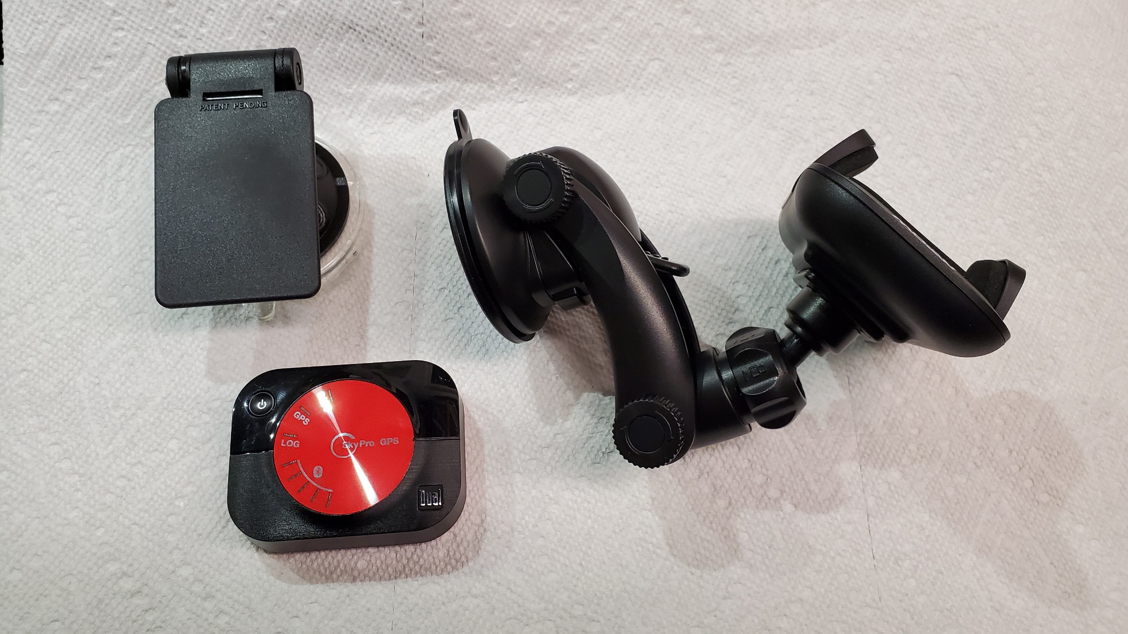

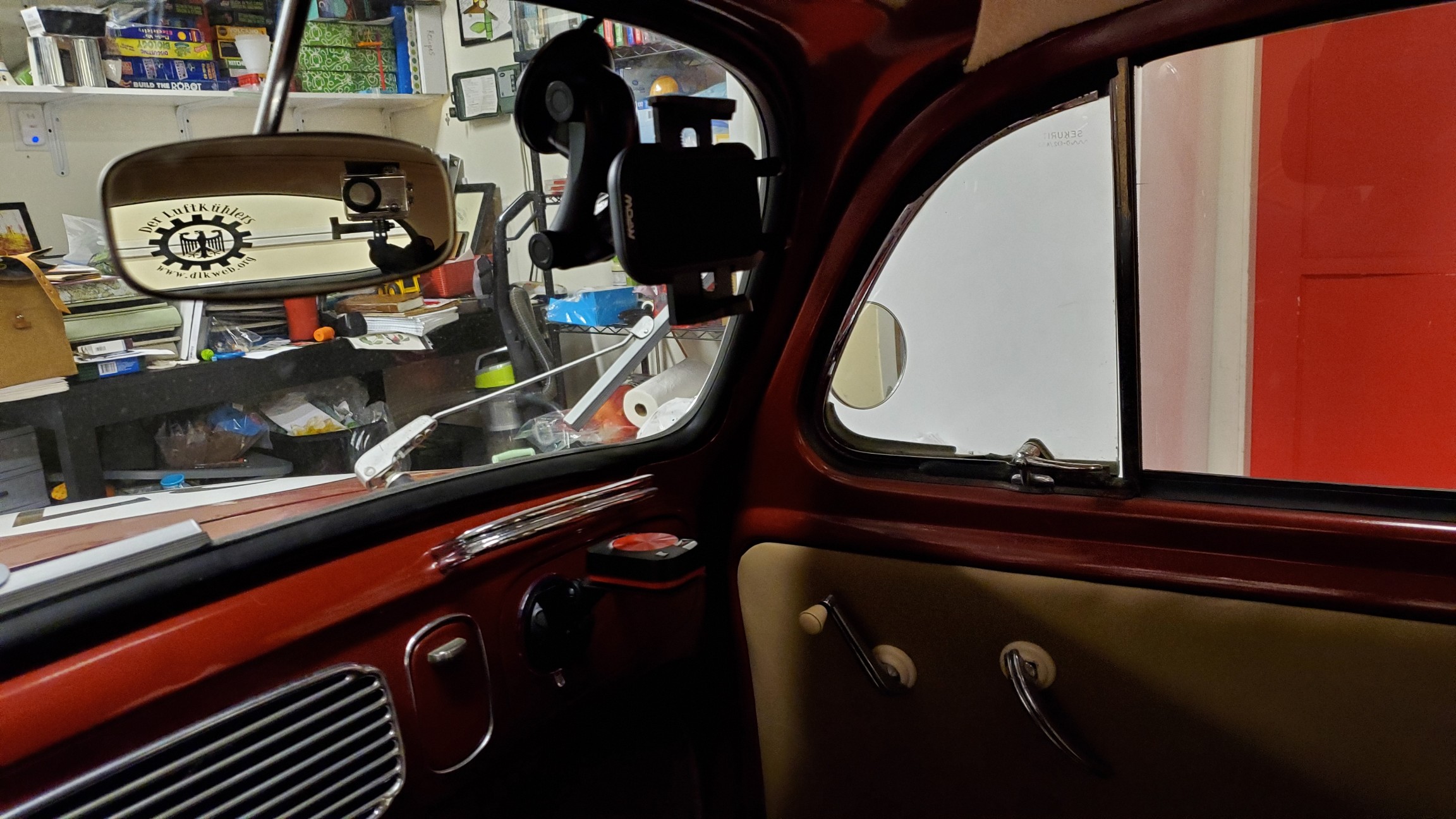

Alright, getting close, day after tomorrow! I found a really cool app that can record video, times, location, speed, and g-force, called TrackAddict. Very cool, been playing around with it for a couple weeks now. Speed and location data are from GPS, and it can use GPS on your phone, but phone GPS's only refreshe 1 time per second, which is really too slow for auto racing. So I picked up a Dual SkyPro XGPS160 that refreshes GPS 10 times per second, much more accurate. Along with that, I bought a suction mount for it and one for my cell phone for using the app and having a good view of the track for recording.

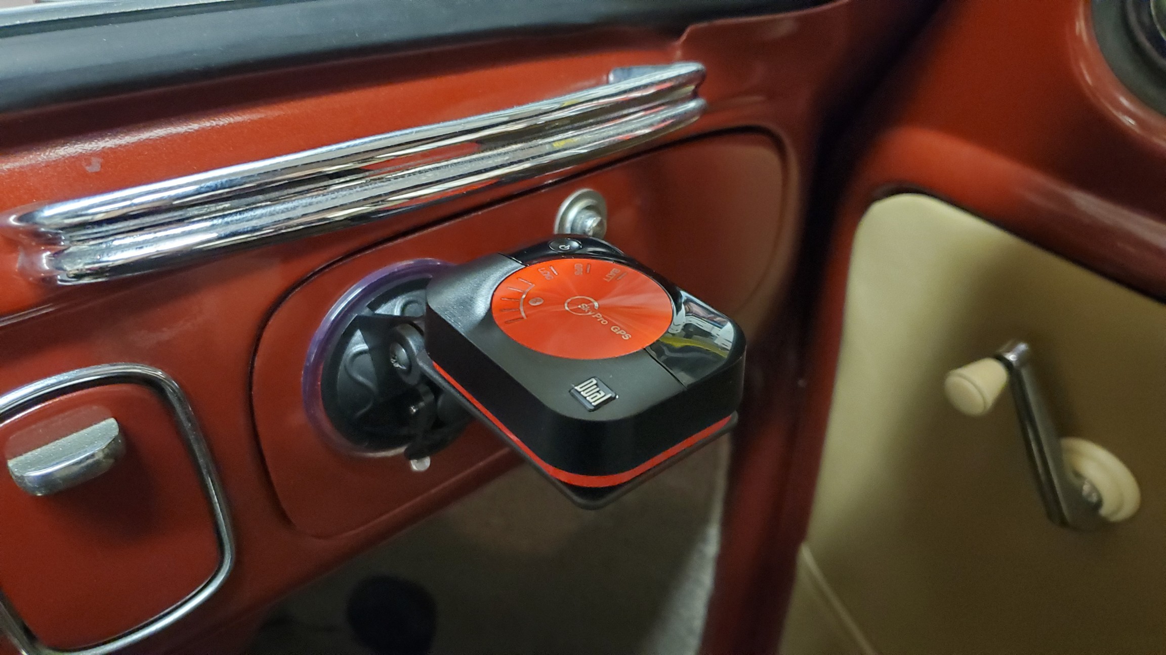

Here's where I'm putting the GPS puck and the cell phone. There is not a lot of spare real estate on the windshields of these cars!

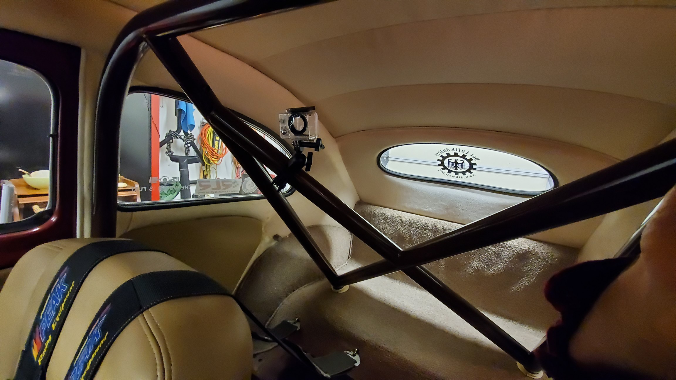

I also plan to record an in-car view with my action cam, here's where I put the mount for it. Pretty handy place to have a rollbar tube!

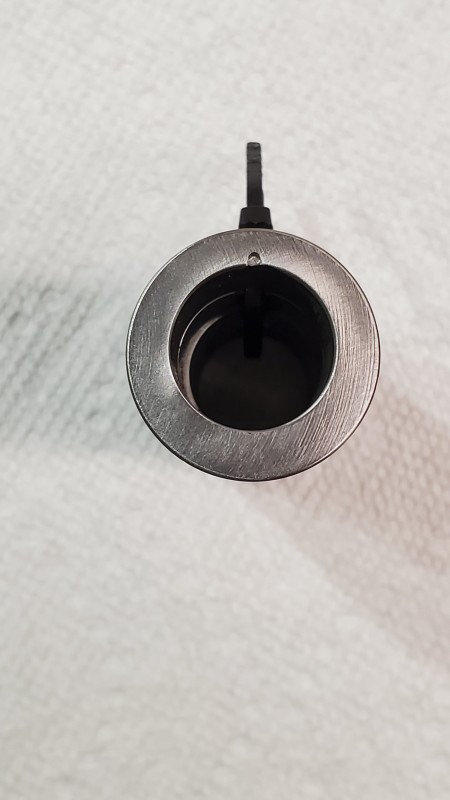

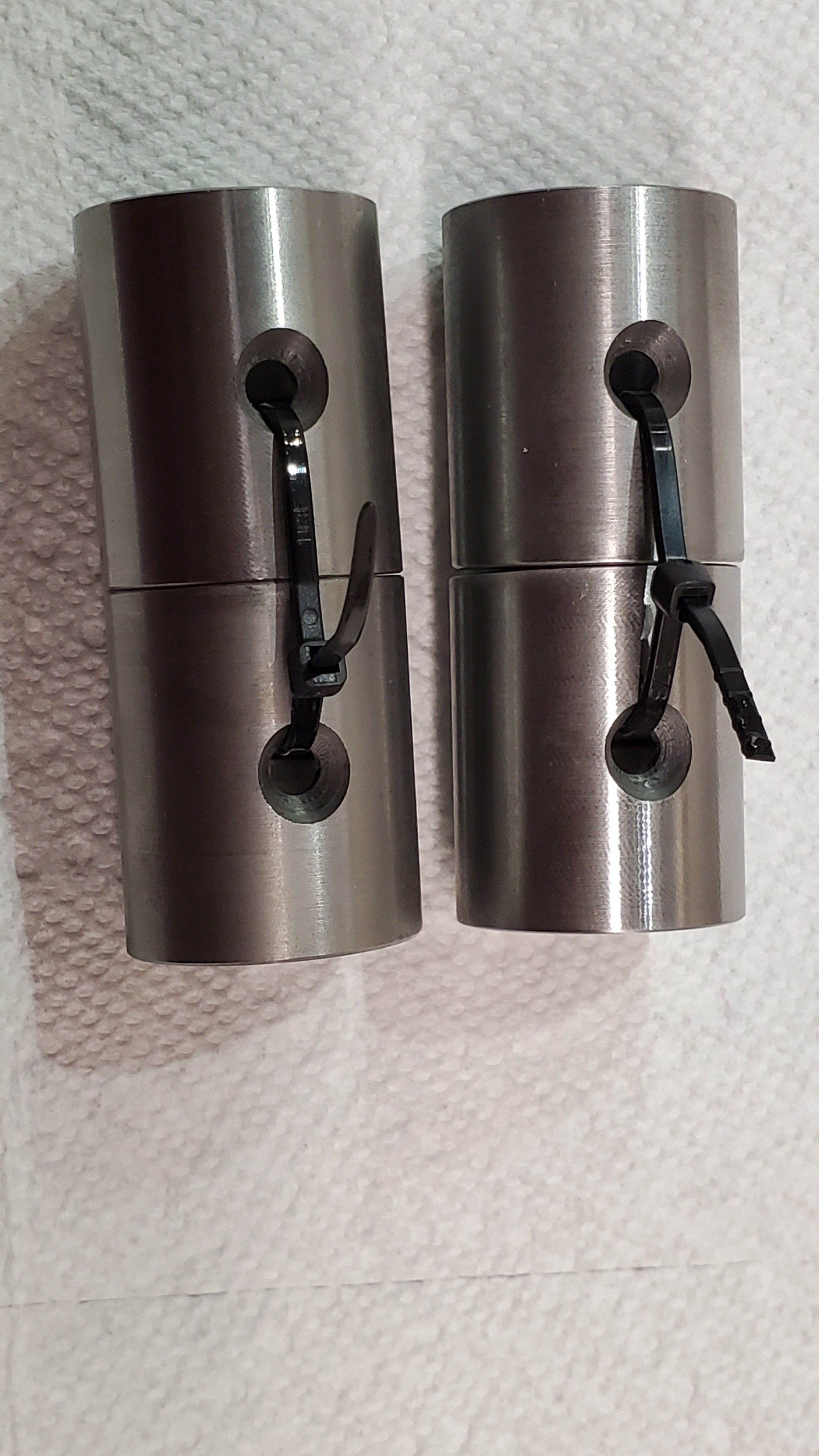

I've also been looking into adding some negative camber on my front end. For link pins, the only way to do it is with offset drilled link pin bushings and a little machining of the carrier's. These bushings are primarily used by the Formula Vee guys, and there's not a whole lot of shops around still providing speciality parts for them. Luckily Quixote Racing in San Diego had them in stock, so I jumped on a pair, along with modified shims to go along with them. It may be a couple months before I get around to putting these on, but I wanted to get them while they're available.
