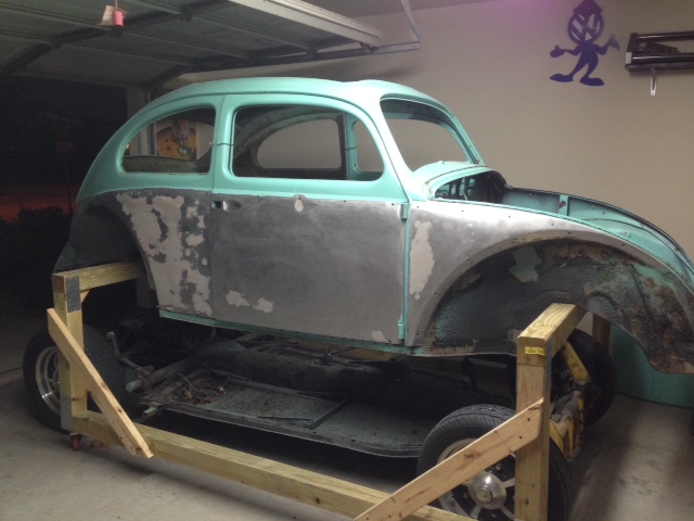

 Post subject: Re: Ragtop 59
PostPosted: Tue Oct 22, 2013 6:27 pm
Work 2hrs... :hillbilly:
