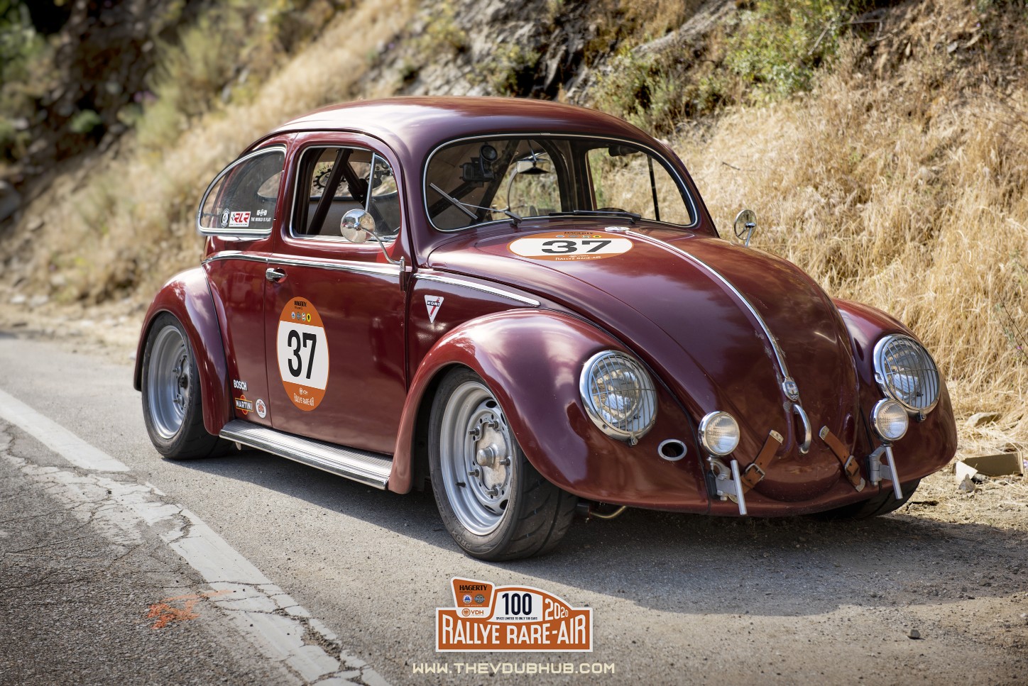

On Wednesday this week I took the bug on a 110 mile trip into the mountains north of here for a photoshoot along with 4 other 40's and 50's VWs and Porsches. The photos and video will be used for promoting a rally that will take place later this year locally.
It was a great day with some really cool cars and great people. They've asked us not to share pictures we took, but they sent me this one this morning and gave me permission to share it, so this is it for now.
The amazing photographer was Timm Eubanks https://timmeubanks.com/
1591371162439_VDUB_Rallye_Hairpin_TEP6056_2_copy_1448x967.jpg [ 443.24 KiB | Viewed 214 times ]
