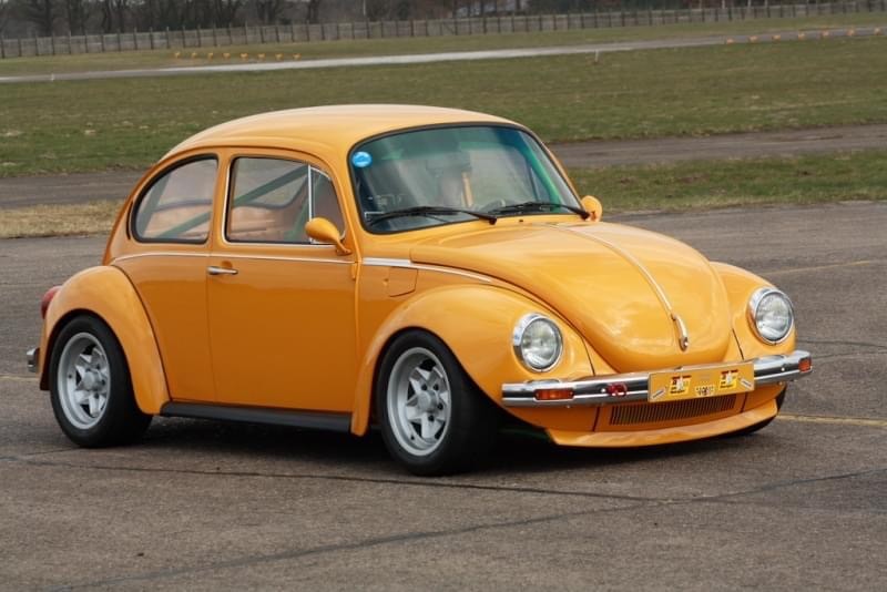

I think this *might* work for you. I've seen it on some GL bugs. Supers though so the curve might be different...
MK1 Golf Lower Front Spoiler

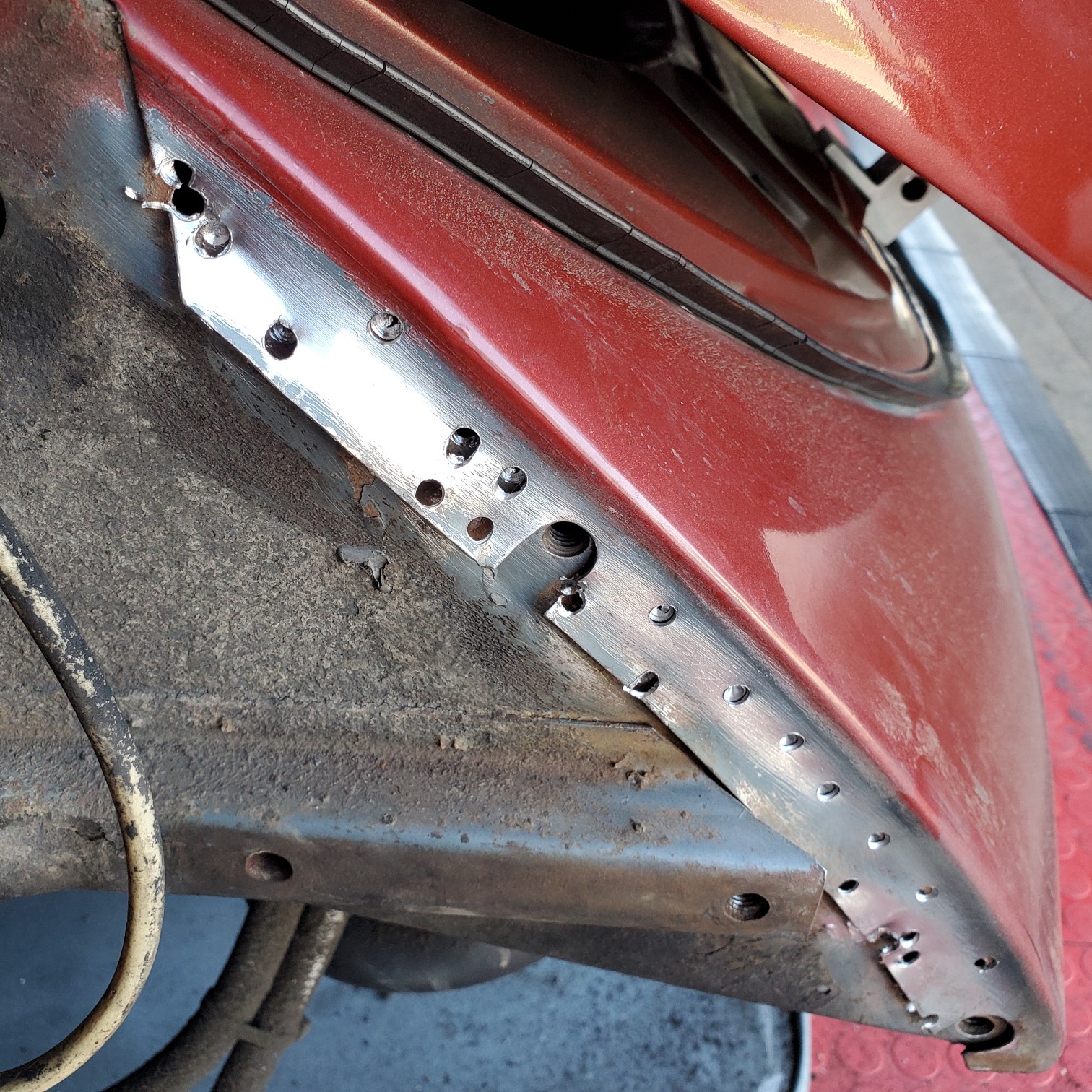

I started on the apron today, to make it removable. What a pain in the ass. I hate drilling spot welds lol. Slow and steady...
It's going to be soooo worth it though when that big ass engine just slides right out :D

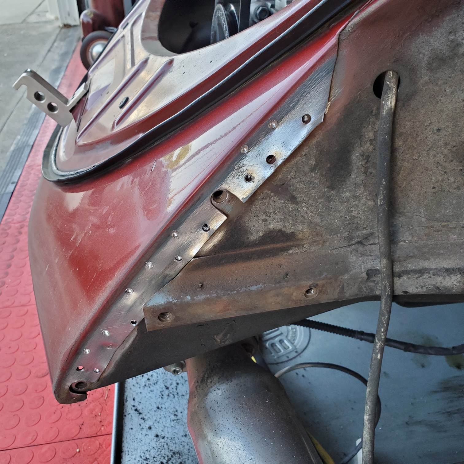

The drivers side is about done, although I think there is one more weld that doesn't show.
