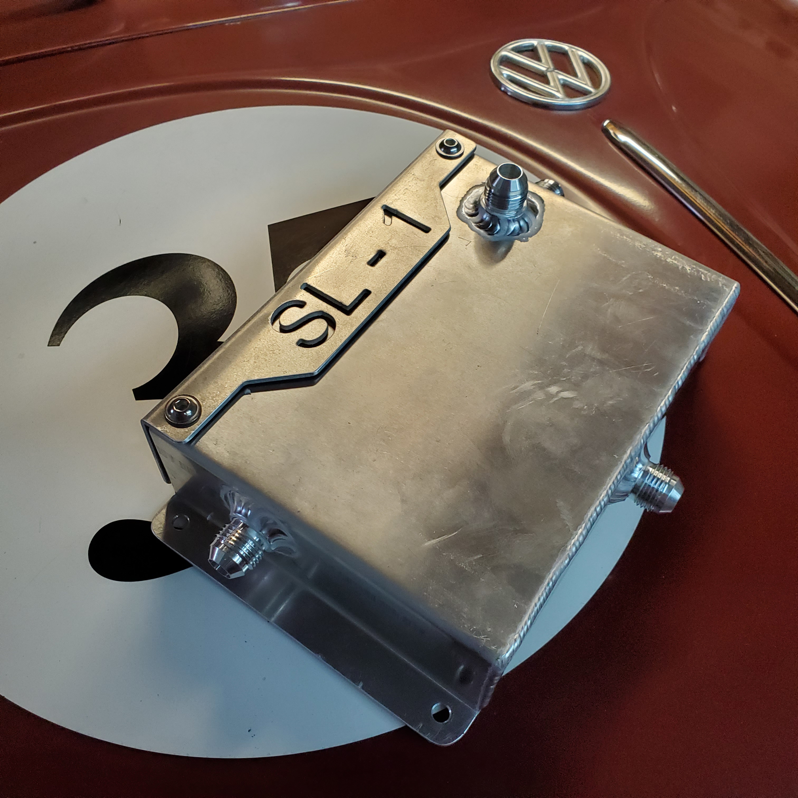

I bought a real breather box from Shagg on Instagram. The little Empi one I believe was filling up and leaking due to not enough capacity. Also, my Pauter rockers are the old style where the adjusters just have through holes in them, so I think my rocker chambers have been filling up and basically pumping oil into the breather. A few people have told me I can replace the adjusters on the intake rockers to ones without holes to reduce this issue. There will still be plenty of oil in the rocker chambers to keep things lubed.
