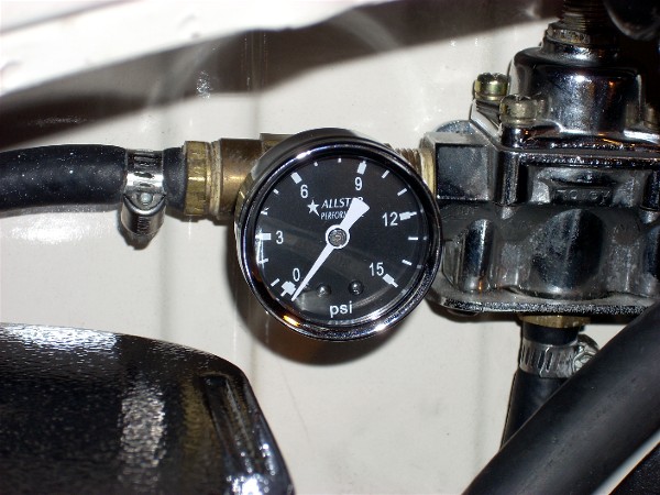

Just a quick update. I picked up a new fuel pressure gauge; most of the stores around town had ol' Mr. Gasket junk. I opted to order the dry-filled Allstar performance unit below. The new gauge is on, but it was too damn late to fire up the Bug and set the psi.
I ended up pulling both carbs. The idle jets (55) looked good but I did find a chunk of junk in one of the passages. I cleaned it all out and put the jets back in. So thanks to all of you that said idle jet problem from 3,000 miles away.
My plan is to get things dialed back in this weekend. After all, there are only so many sunny days left in Michigan before the snow flies.
File comment: 0 psi = zero fun
