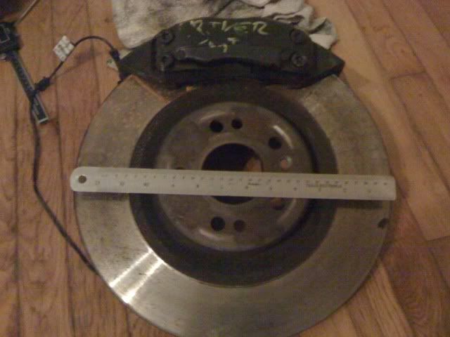

Some big ass Brembo's for the front of the notch, Thanks Santa!!!!! :D

What are those off? What wheels are you going to run?
PostPosted: Sun Dec 26, 2010 9:34 pm
'99 mercedes ML430 and i'll be rolling on 17" Cup II's
I was really hoping to use these rotors but I might not be able to go with 5x130. These rotors are 13.5" by 31mm and the bolt pattern is 5x113. they are friggin HUGE!
PostPosted: Sun Dec 26, 2010 10:38 pm
What size master cylinder are you going to use?
PostPosted: Mon Dec 27, 2010 5:50 am
i still have to figure out what i'm going to do for the rear, then calculate the the piston sizes and get a remote dual master cylinder. or if i want to be cheap a NA 944 one with proportioning valves on the front brakes.
