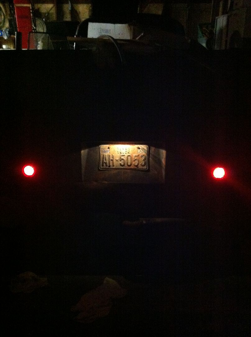

Thanks for the pic E! The lights are nice and bright. The turn signal/brake lights are even brighter. I guess that Ghetto Chrome tape did a good job.
Head lights work now. Had a bad ground. Common problem on this truck. God Bless my Dremmel!!! lol! Passenger side Parking light needs a new wire. Easy fix. Interior light needs new 12V bulbs and it should work. I broke the damn lens, but it was cloudy yellow anyway. Horn is next and that should just be a parts swap/ clean the ground......

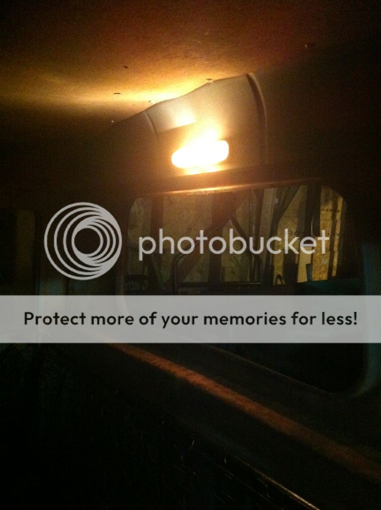

The interior light has been fixed. Bad ground and gunked up contact surfaces. Dremel has a small brass brush that does wonders for these types of repairs. I need to rewire 1 parking light and fix the horn. Then all the electrical will be sorted.....
