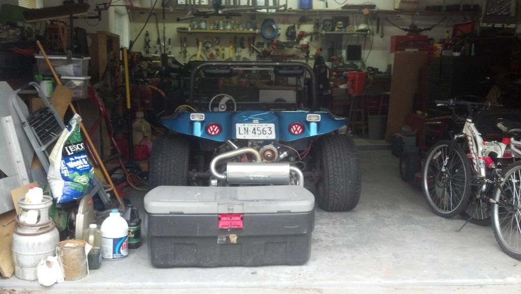

Made some progress on the old Buggy this weekend. Now that we have moved and I actually have a garage to work in, I'm starting to feel a little more motivated :) We stopped by work this weekend and drug it back to the new house. After moving a bunch of the landlords stuff (long story) we actually were able to get it into the garage. Spent a few hours tinkering with things and finally got it running Sunday. Me and the kids took it for a quick spin around the neighborhood and it did surprisingly well for not having been driven for the past year. Still got some things to do to get it ready to go, but now that I have the space, its just a matter of time.
In this pic, the only things in the garage that are mine are the buggy, the tote behind it, and the two bikes......
