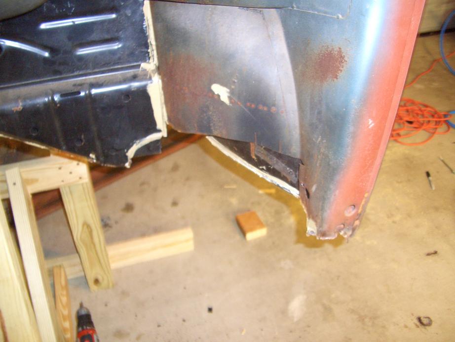

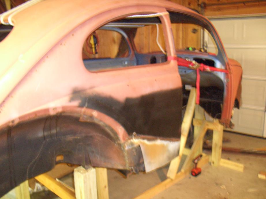

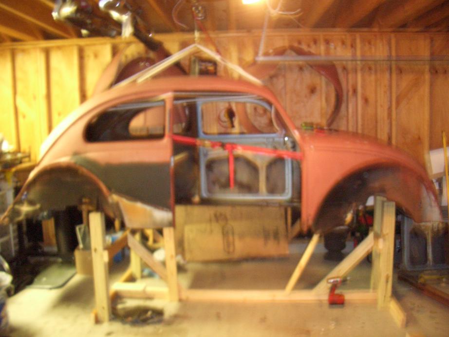

Well here we go. I started today by removing the "patch panels" the p/o put on the car to see what i was in for. It doesn't look good, but i think that i am up for the challenge. I think the car is still in salvageable condition. I will keep you guys updated throughout the process.
Here are pics after i removed the pass. heater channel and the patch panels. Sorry for the blurry pics.

PostPosted: Fri Nov 07, 2008 11:39 pm
uhhhhh, where's your bracing? :?

Unless you have that car bolted to that wooden frame, before you cut the channel out, you are going to have a good time getting it back together. On another note: you didnt waste any time did you :shock:

OK. Here is the deal. I will argue my case against the bracing. I did not want to weld in bracing between the a and b pillars because the gap between the both of the was not the correct width to begin with. I didn't see the point in bracing the car, welding in the heater channels and still having a door opening that is misaligned. In addition to that i have slight tension on the roof of the car courtesy of the wench mounted to the ceiling of my garage which keeps the body from twisting out of shape. I am also doing one side at a time to maintain some structural support.
After i get the a pillar repaired and the fire wall welded in better i will mock up the heater channel, take all the appropriate measurements to ensure that the door opening is correct, tack in the heater channel, test fit the door and then i will weld the heater channel in solid.
