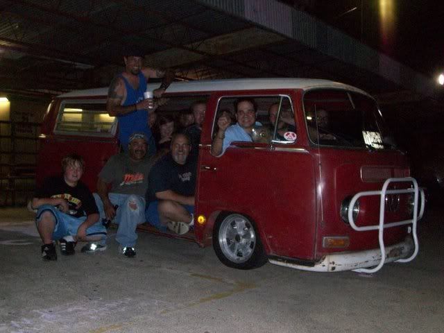

Apparently, the Roo Bar hangs a BIT low.
Although it looks sick with my emblem.
So anyway, here is my bay. '69 Deluxe. 4" Narrowed beam, drop spindles and horsehoe plates. Rides good, just gotta get used to how it handles, or find a new steering box.
