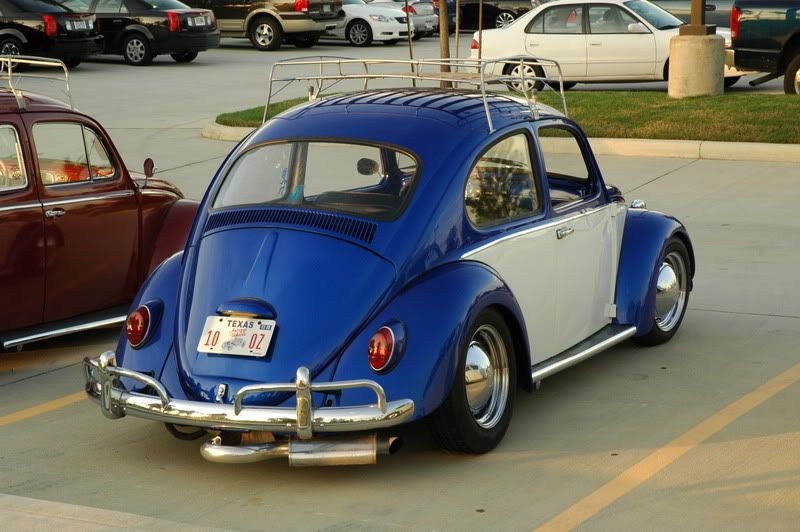

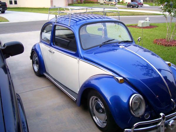

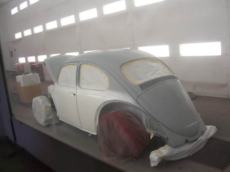

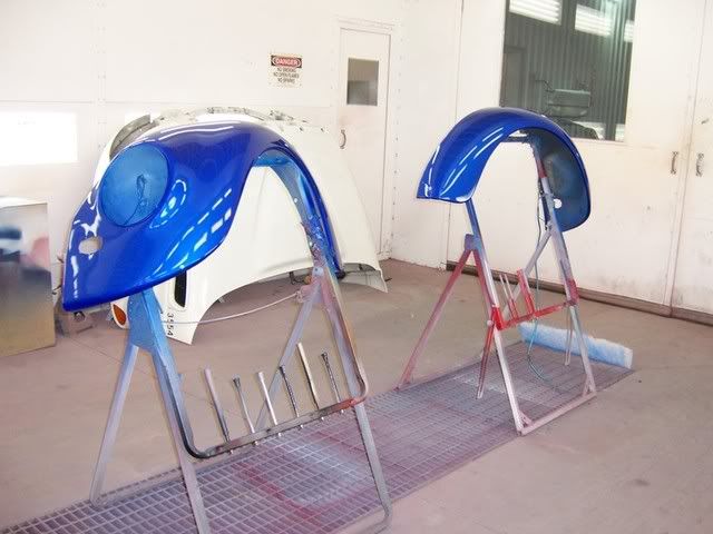

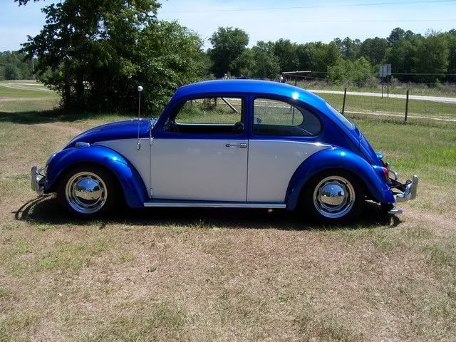

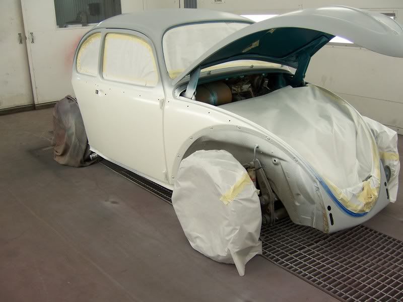

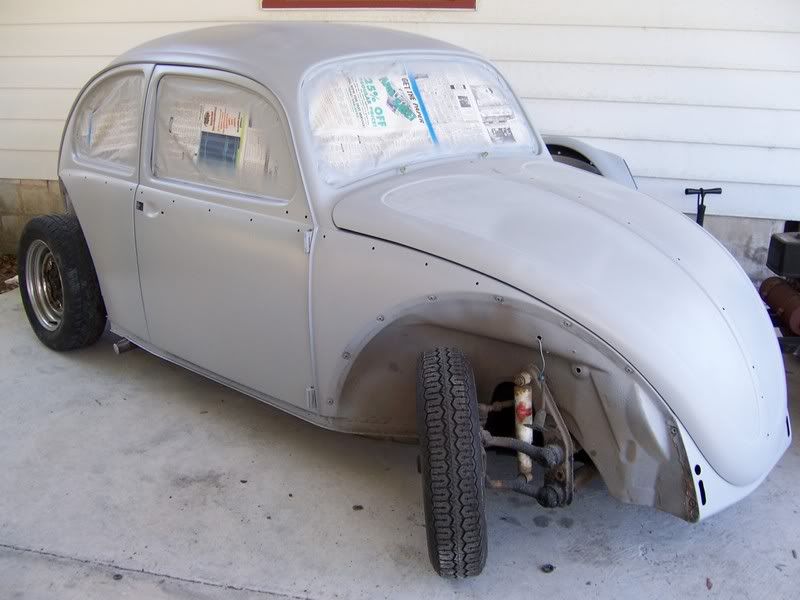

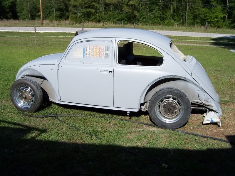

This is my 1965 Bug

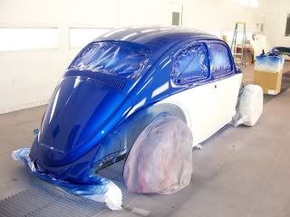

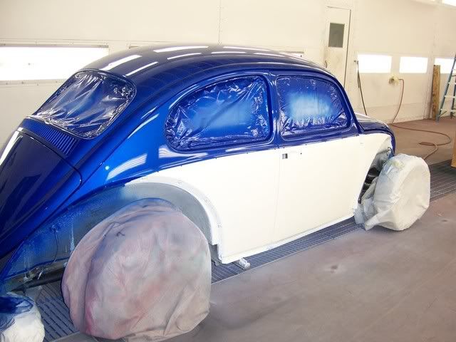

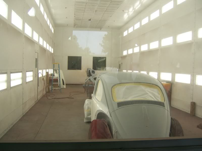

Headed to the Painter

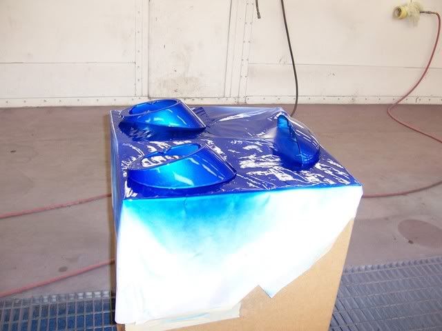

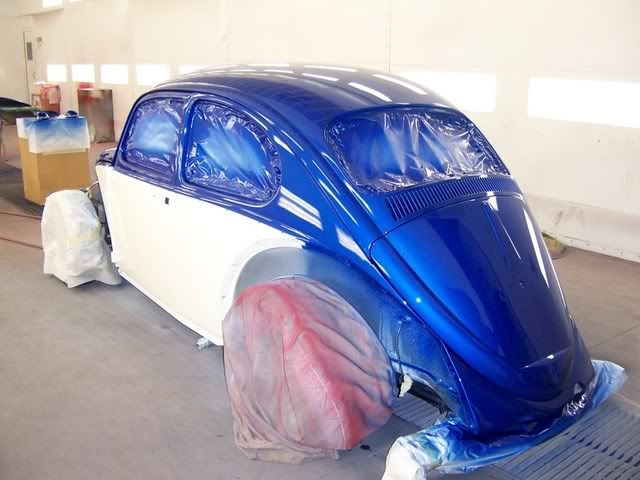

The white goes on QX3 three stage
And now the Blue B17

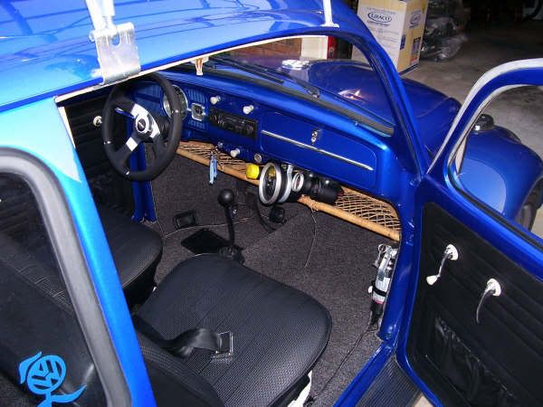

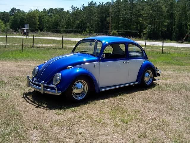

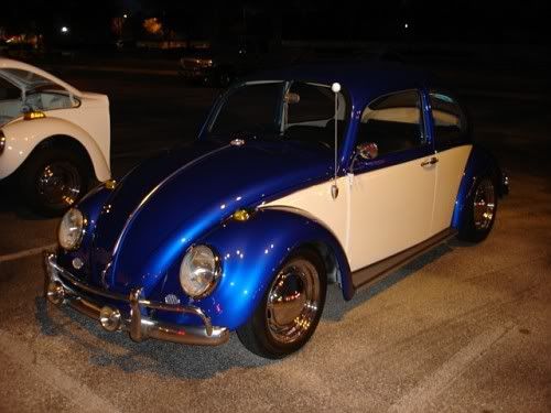

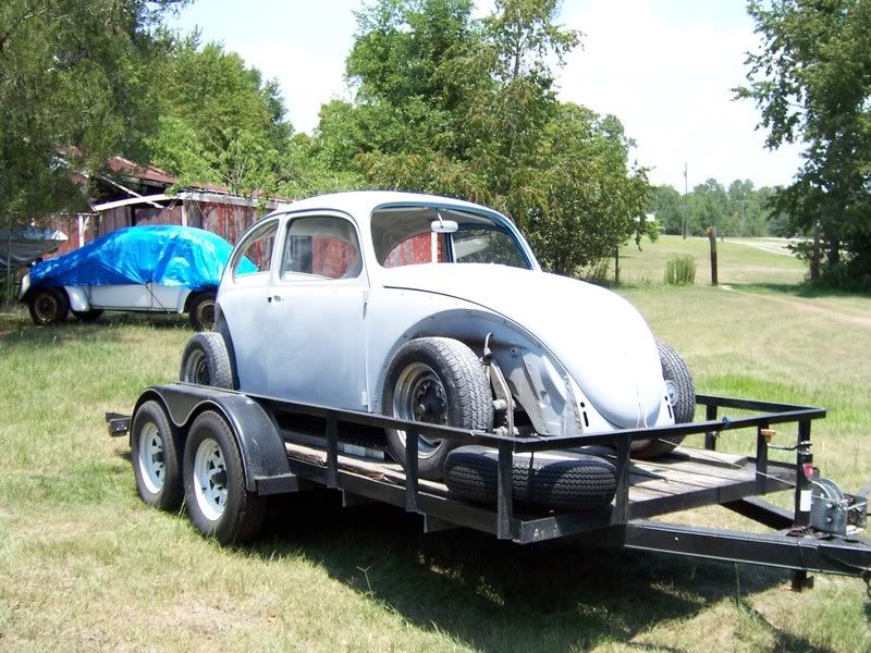

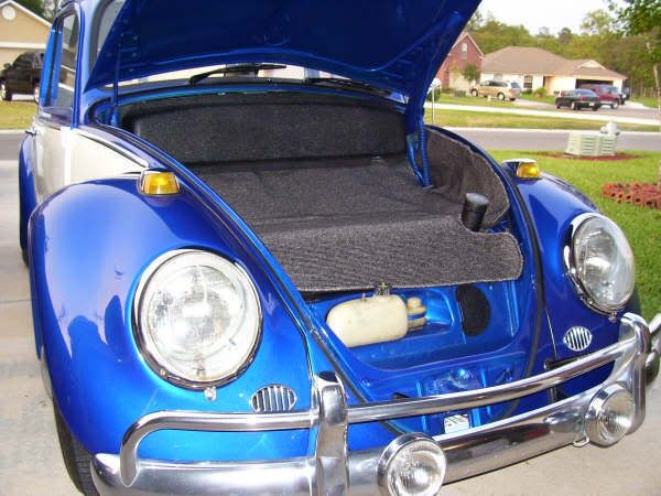

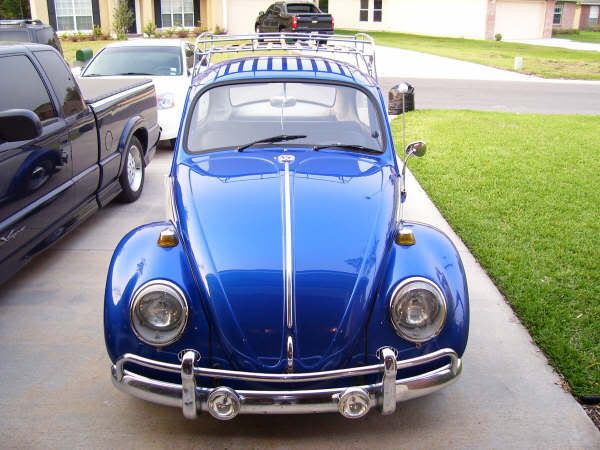

Some more photos
 Post subject: Re: Ethan's '65
PostPosted: Sat Feb 02, 2008 12:34 pm

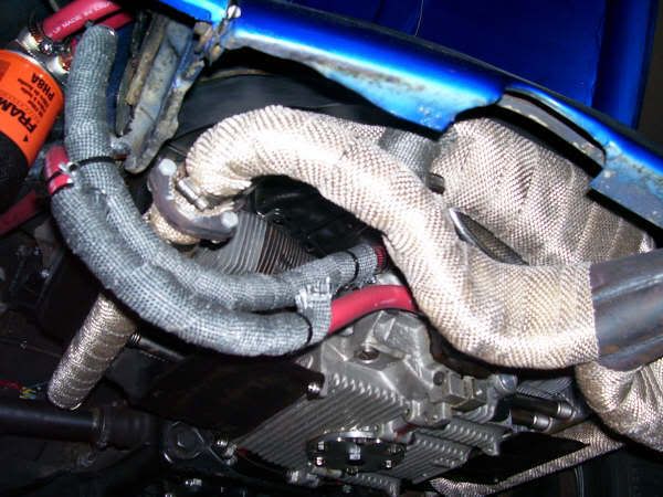

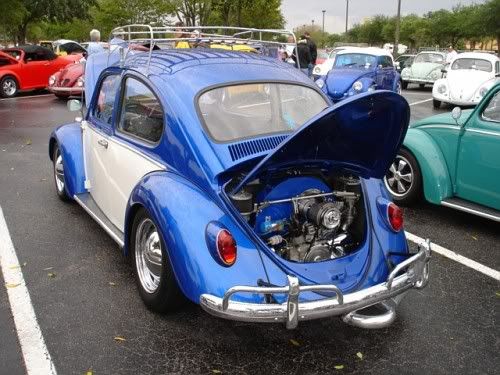

and more
motor-all new 1967cc empi block, 92mm mahle piston and jugs, scat H rods, engle 120 cam, mahle high volume/high pressure oil pump, remote oil system, 74mm scat crank, cb performance heads 40x35.5
, empi rocker arm system, dual 40mm dellortos. 9.25 to 1 compression , electronic ignition bosh 009 dist.
transmission- new rancho trans pro street with a kennedy stage 1 clutch. close ratio and freeway flyer 4th gear. 12 pound flywheel 8 dowl

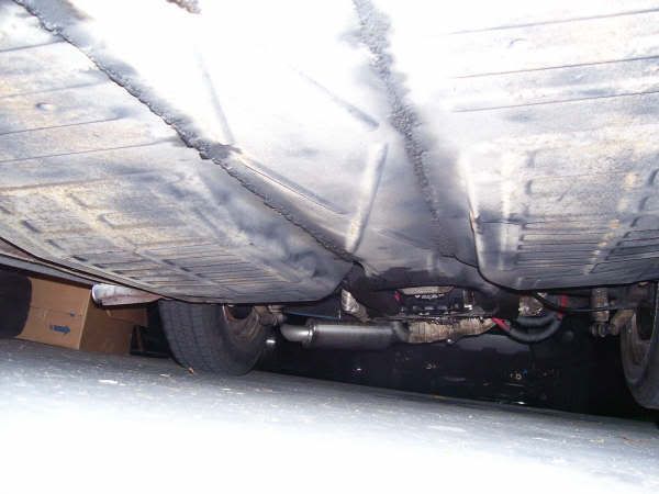

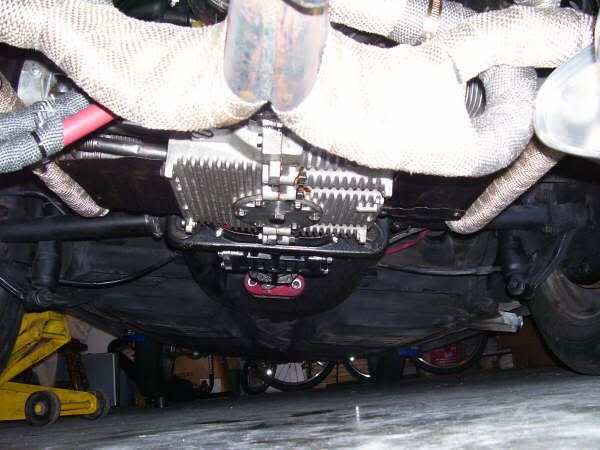

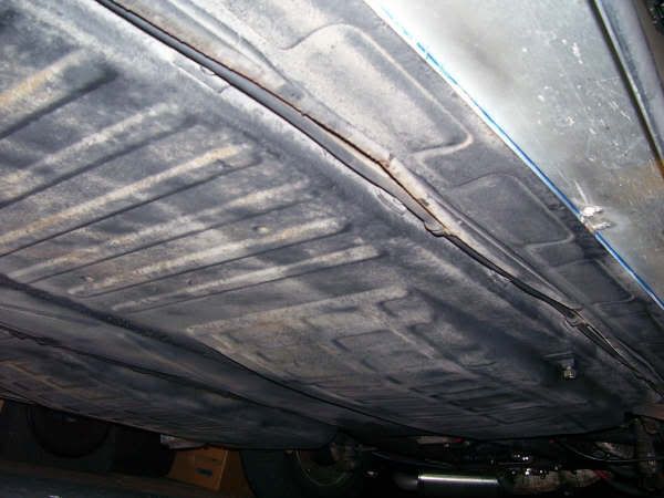

some pics of the underside

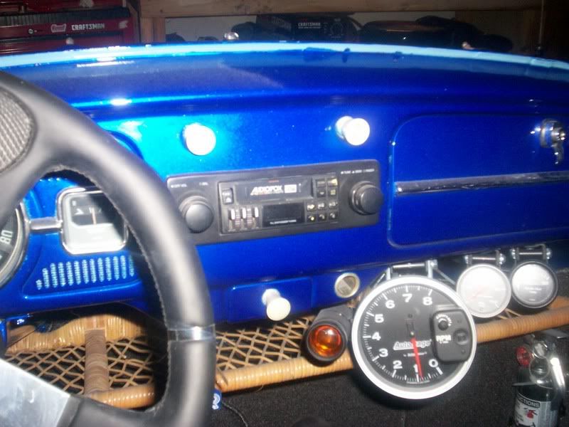

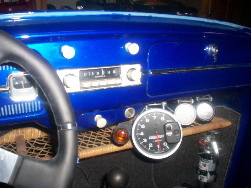

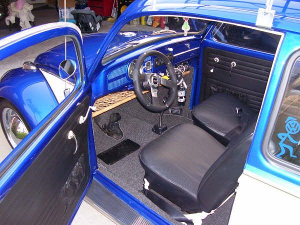

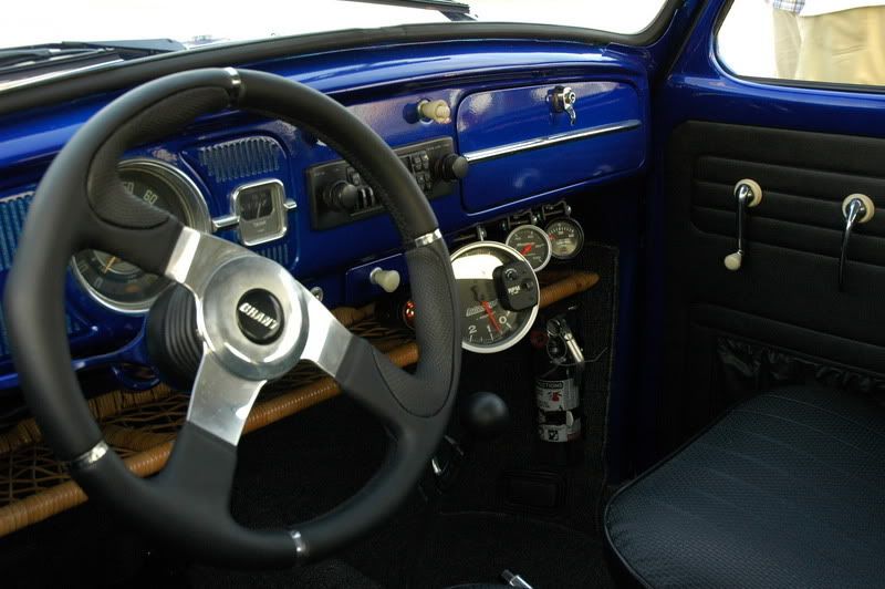

old radio
New old radio

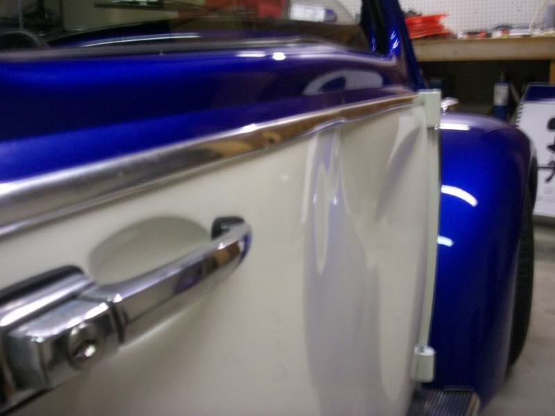

Here is a couple of pics after a duel with a chick in a suburban who didnt look before she pulled out.
worked a number on that door

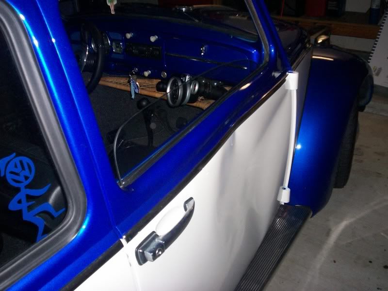

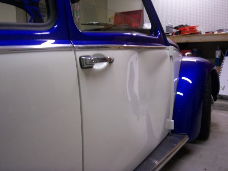

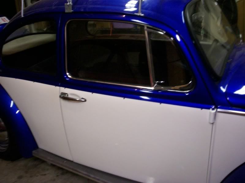

And the new door with fresh paint :)
Did yall notice something diffrent??????????
old door (besides the dent )
new door
