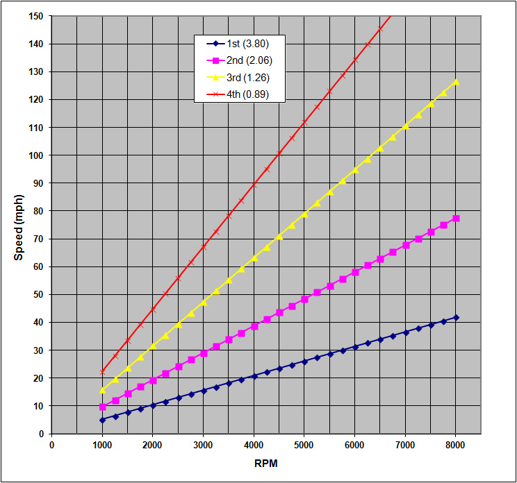

I think Murray is running a tall tire, 205/70, making it just over 26" tall.
yeah, currently running a 205/70. which means i guess i could get a little more out of the .89. At this point, I think my two choices are the 3.88 with .89 (like ScottyG runs) or a 4.12 with .82. I've been told a 3.88 mainshaft is stronger but is that really a contributing factor for me? I "drive" my car, it won't be at the track, AT ALL.
PostPosted: Wed Jan 14, 2015 4:13 pm
The main shaft is 1st/2nd...
The 3.88 R&P is the strongest due to its thickness compared to the other options. If you're not planning on abusing it and not making huge amounts of power then any R&P will be fine...
Here's your car with a 26" tire, 3.88 R&P, and .89 4th. Looks like a good freeway cruiser 8-)
