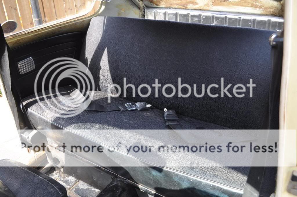

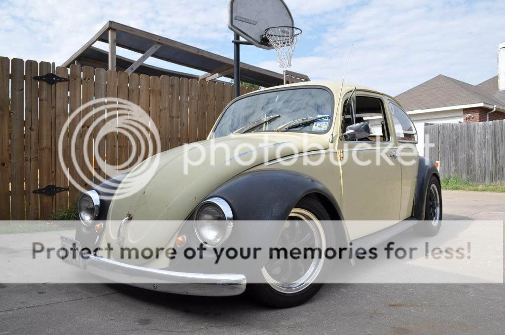

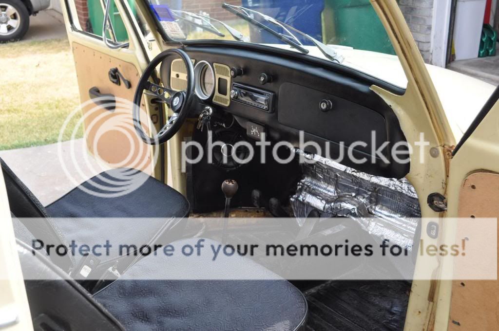

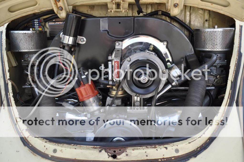

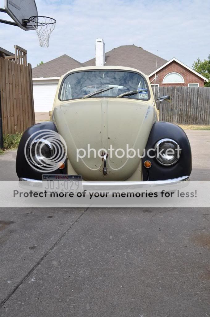

Lowered in front with narrowed/adjustable beam and drop spindles, rear lowered via torsion bars(my best recollection is 5 inner/6 outer). Front disk/ rear drum brakes about half life left. New rear wheel bearings installed 5 months ago. 15in 8 spokes with 175/55's on front and 195/60's on the rear Old style blade bumper on front with chrome nurf bars mounded in the back. All 4 fenders and running boards are new with the fronts being smooth with no signal markers. Car has a little rust in front and rear apron, bottom door sills and some small holes in and around fenders. Car was found in a field and has suffered some hail damage but not real bad. Wiring has been reworked with the addition of a new blade style fuse box and terminal blocks front and rear, newer battery. Rear windows are pop-outs. A 1914 with 041 heads pushes the car down the road, dual kadrons , alternator, deep sump oil pan, remote filter, merged header, electronic ignition and fat boy muffler keep it running. All tins are in place and restrictors made for lack of heater boxes. Interior needs carpet and head liner. Seats are in good shape for their age, back seat has one tear/hole. Window rubber and door seals are new, have new dash pad(not installed) and new glove box(installed). Pan has been sealed with master series. CD player with 2 6in. speakers mounted with plastic kick panels.
Now for the pics!

Looks like you have a good start.
 Post subject: Re: 71 slam bug
PostPosted: Sun Feb 03, 2013 8:15 pm
Reminds me of my first Bug..... :thumbs:
PostPosted: Mon Feb 04, 2013 12:00 am
Posts: 474
Location: Dallas,Texas
Oh yeah looks great,you got a great starter there. Like how it sits.
