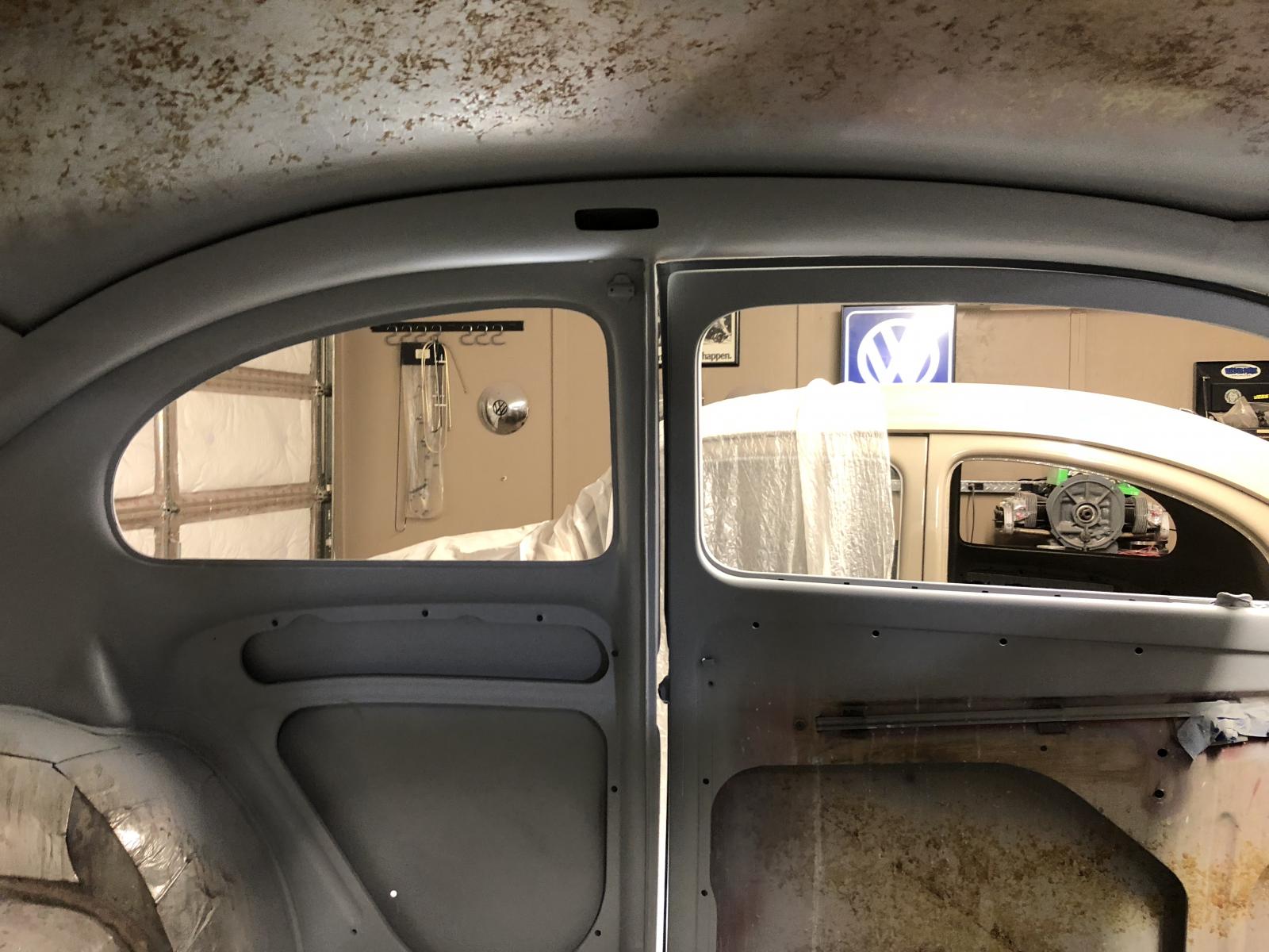

I fixed some holes in the fiberglass front end. That was my first time working with glass. I also welded up about 10K random holes drilled under the dash and deleted the fuse block hole. After that I turned my attention to the passengers door and rear quarter they are the worst areas on the whole body. Geez that took all day but I did get the first few coats of primer on. I will block it and fix anything I missed and prime it once more.

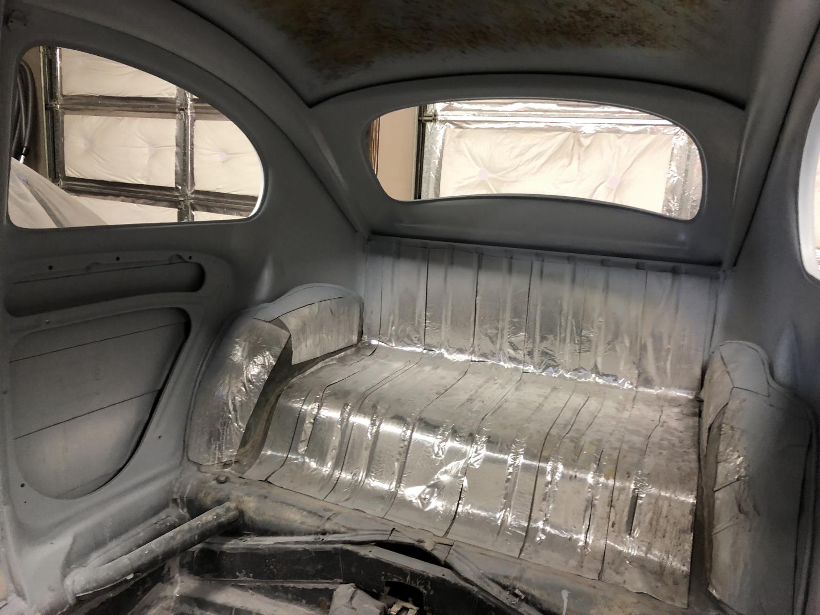

ran a bead of seam sealer on the inside of the pan between the lift and the pan and between the lift and the heater channel and treated all the surface rust with rust converter. Then installed some sound deadner ( yep the cheap kind from Home Depot) also got the front end primed.

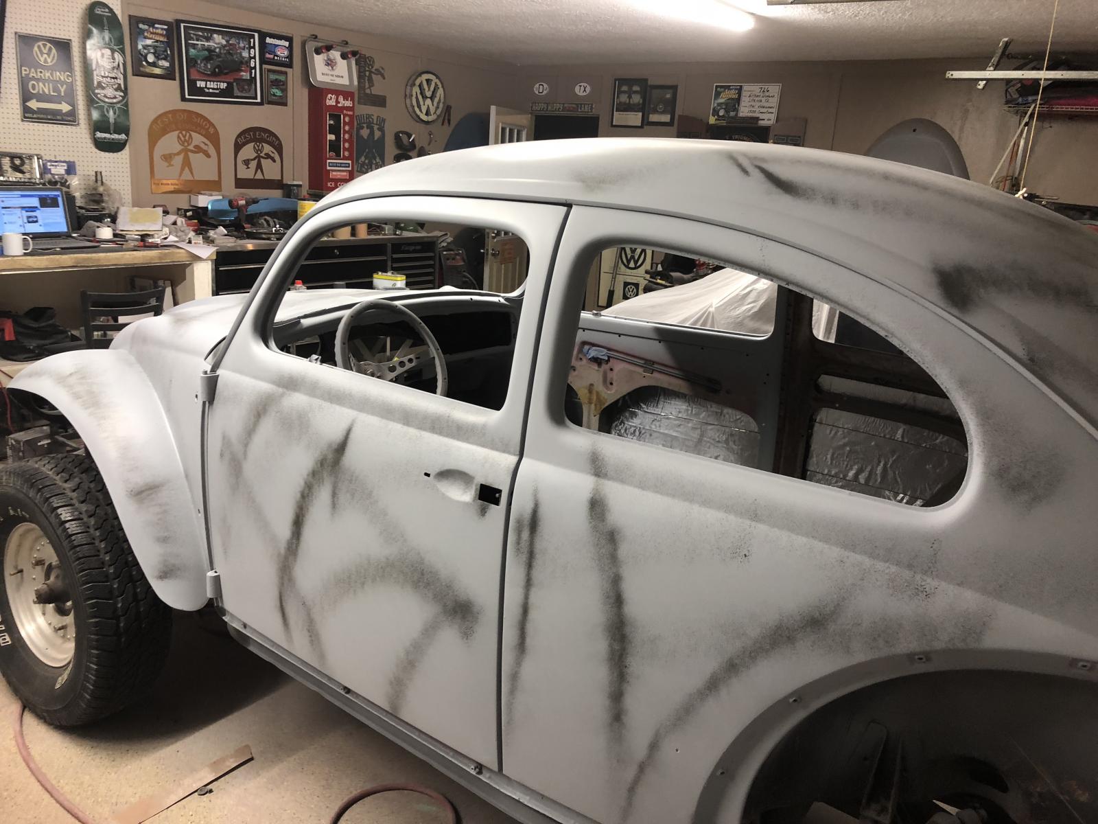

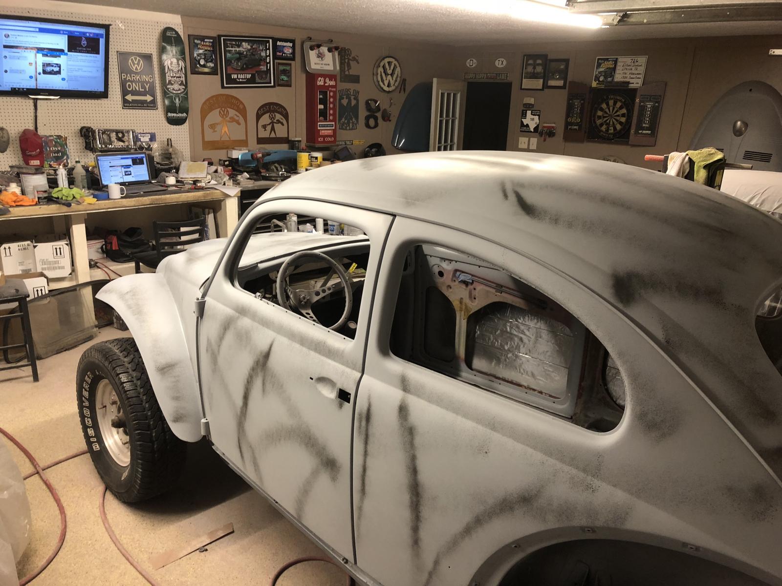

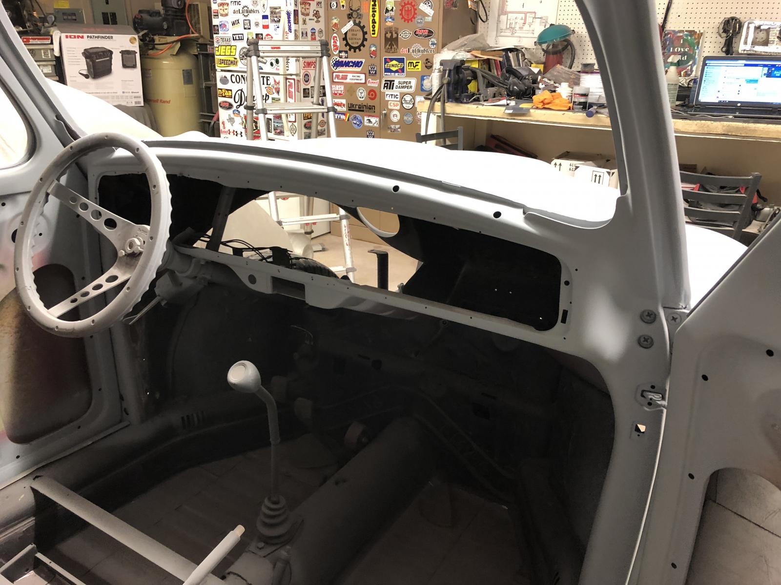

a ton of blocking
I can not wait for this stage to be over, it is gonna take me a week to empty my garage and clean it.
Blocked with 180 and primed again, then wet sanded with 400
Headliner clips delete

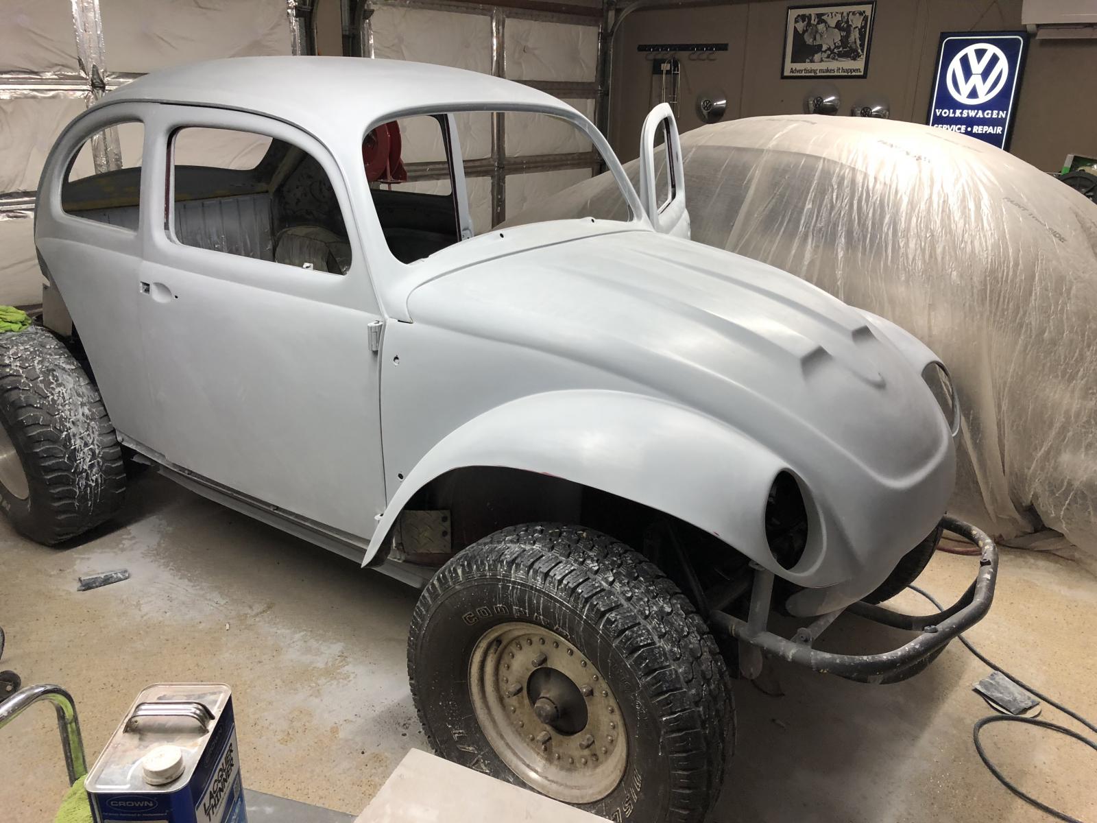

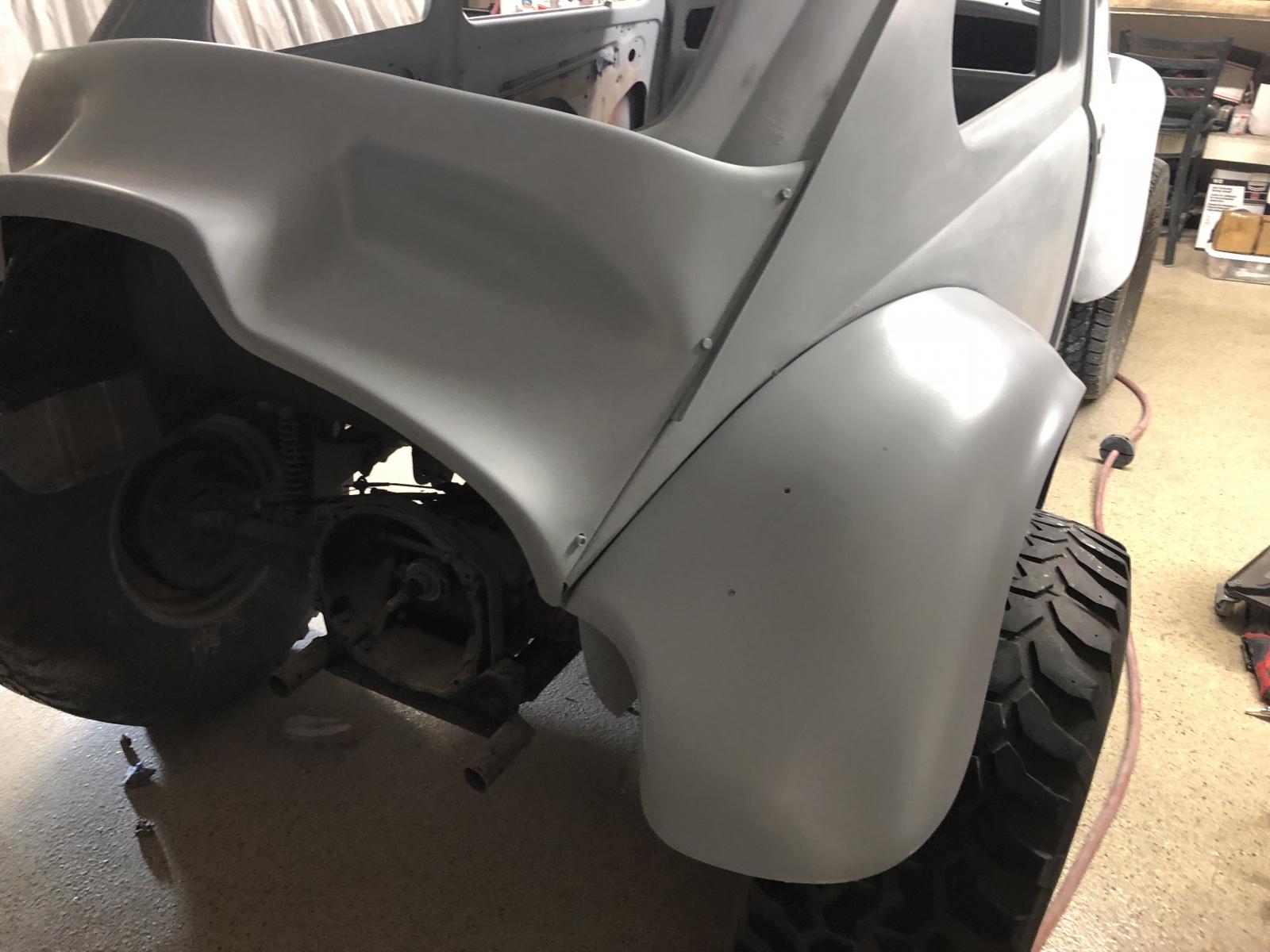

Got the new rear fenders and lights mounted and primed.

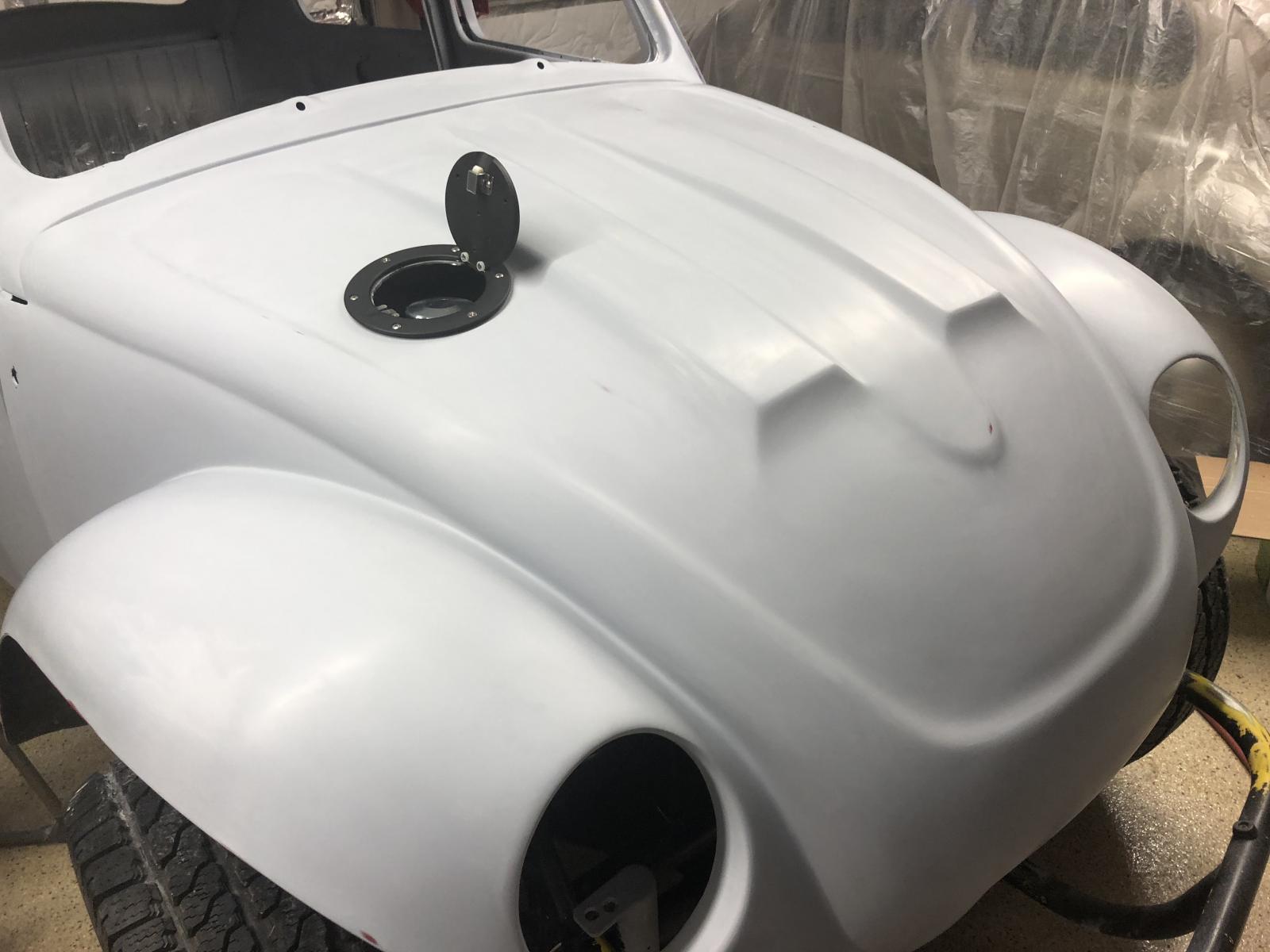

update... a final push for paint, got everything wet sanded and cut the access hole for the fuel tank.
