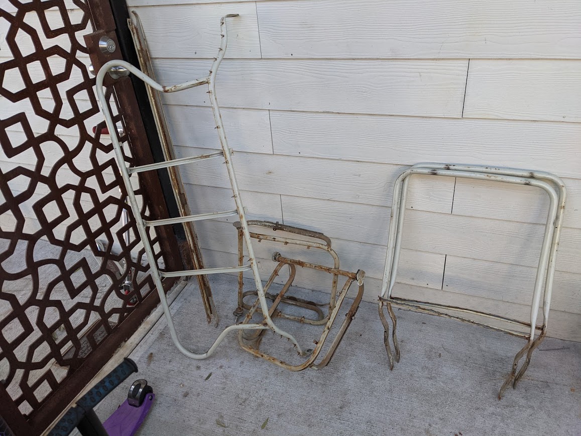

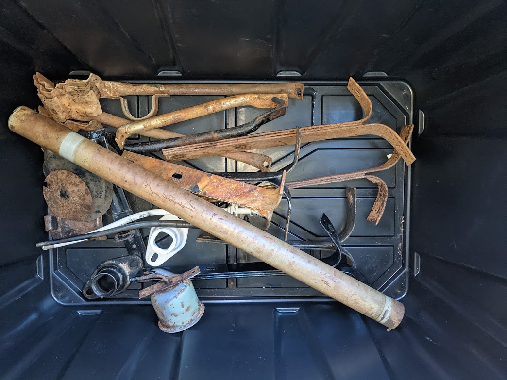

Switching gears, over the weekend I stripped down the interior to get everything ready to send out for powder coating. Do any of you guys have recommendation on powder coaters? Note I am in Houston.

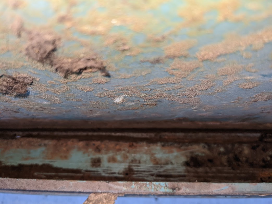

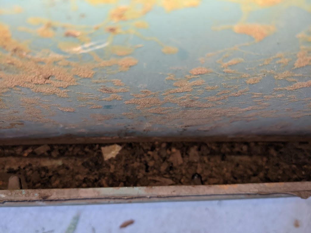

I also pulled the OG door panels. I really got to this car just in the nick of time. The window scrapers both outside and in are bad shape to say the least. They've let in dirt and water. The bottom of the doors were filled with nasty damp sludge. When i pull the doors for hinge pin replacement I will power wash them because there is only so much a shopv-vac can do with mud. Although there is surface rust in the bottom of the door they're still really solid. I do see the drivers door bottom corner closest to the A pillar does have filler that once the car is blasted will need a patch panel.
I also pulled of the Volmac seat re-cliners and cleaned them up a bit. Note seeing these on the car is the only reason why I bought the car to begin with.
