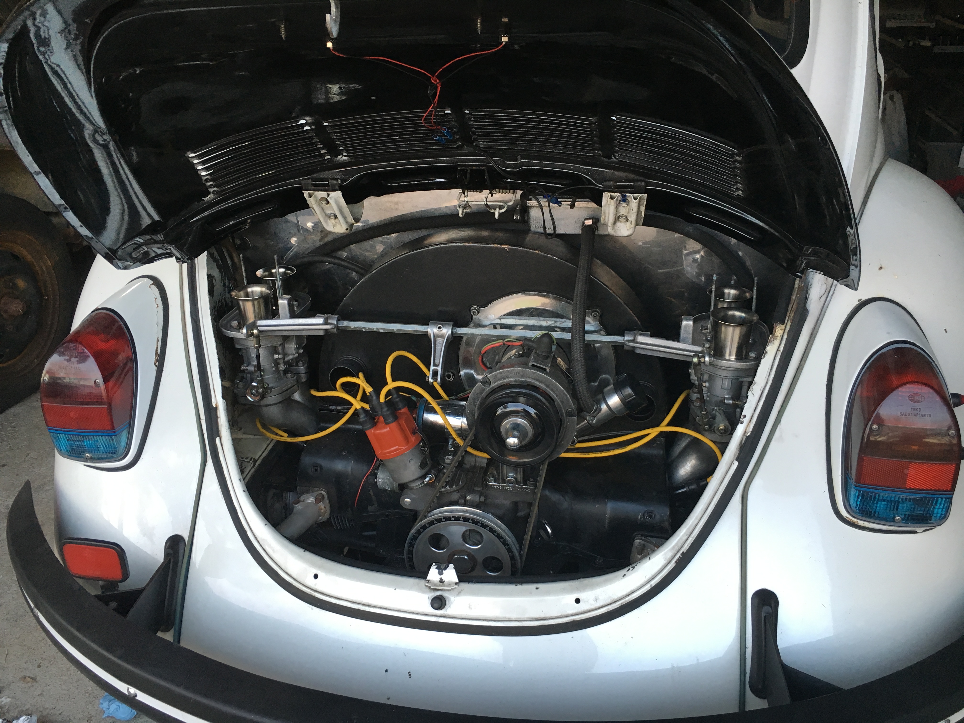

Ok so I have power at the coil and I used an inductive pick up to determine there's power through three plug wires. Turns over but never seems to fire. Carbs have gas and accel pumps are working. I checked the points gap and it's good. What should I check next?

PostPosted: Mon Jan 18, 2016 5:58 pm
11 volts across the coil with the ignition on
 Post subject: Re: Cranks, but no start
PostPosted: Mon Jan 18, 2016 7:06 pm
What has change since the last time it ran?
PostPosted: Mon Jan 18, 2016 7:09 pm
Just the carbs. I cleaned them and reset them to the basic starting point
PostPosted: Mon Jan 18, 2016 7:11 pm
SO you smell gas ? Timing ? basics , spark at the plugs , gas in carbs , wires on the right plugs , hmmmm..
PostPosted: Mon Jan 18, 2016 7:15 pm
Timing hasn't changed. Haven't moved the dist. I can see gas squirt in the carbs. The inductive pickup from the timing light picks up power in all the wires, EXCEPT number one wire...
PostPosted: Mon Jan 18, 2016 10:16 pm
Have you tried using starter fluid?
PostPosted: Mon Jan 18, 2016 10:34 pm
Yup. Miguel came over and we tried that. Seemed to help a little but still no catch. We tried his coil and condensor that we knew were good. Same thing, just cranked and cranked. New rotor and new cap too.
PostPosted: Mon Jan 18, 2016 11:11 pm
I do have brand new plugs that I can throw in, but the ones in there weren't very bad at all.
PostPosted: Tue Jan 19, 2016 9:43 am
Are you sure you see spark at the plug wire to ground? If you have fuel , spark and timed. it should at least try to fire.
